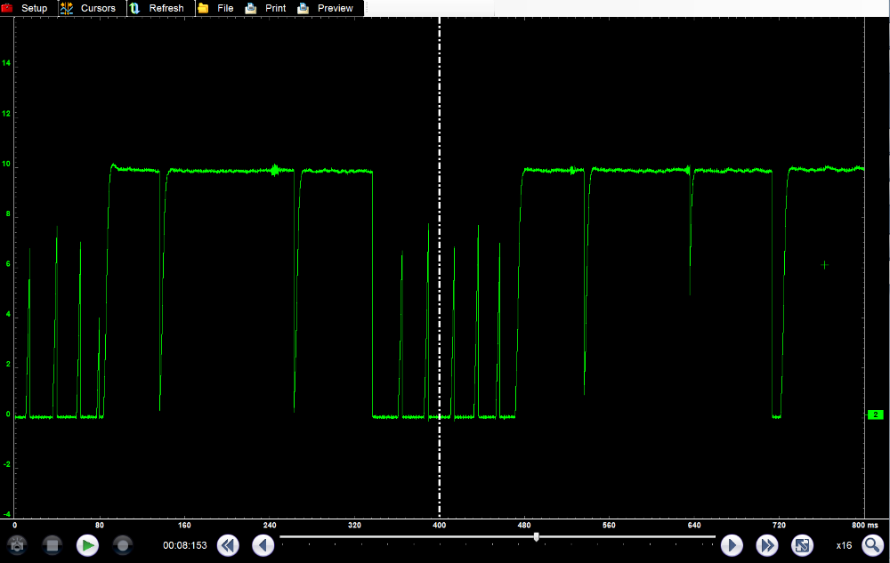

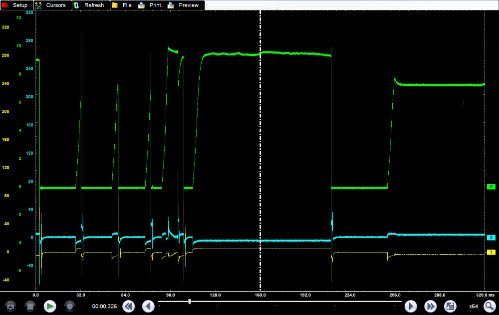

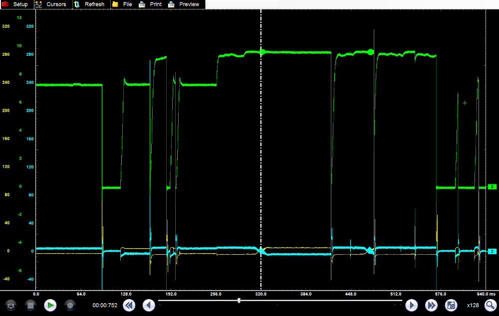

Any thoughts on these waves? Green trace (#2) is Coils 1 & 2 Current. Yellow trace (#1) is coil 1 control. Blue trace (#3) is coil #2 control.

I'll take crank sensor for $200, Alex. ;-) :lol:
But seriously, those captures are b.a.n.a.n.a.s. Does this thing even run? I think cam/crank would be my next check.

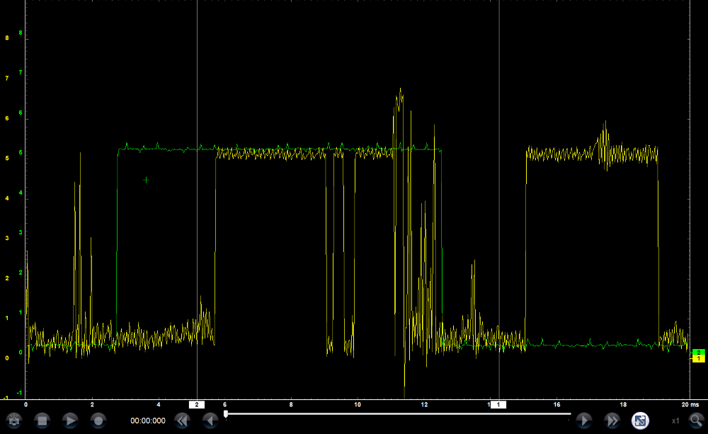

It runs. It idles, nicely. No load, WOT snap, just fine. Can even power-brake.:huh: But put it in drive and start driving and, within a few yards, it turns to CRAP. Sputter and stumbles and lurches...it drives just like the waves look. I'll get waveforms of the Cmp and Ckp, tomorrow.
I'll also go over the wiring harness with a fine-tooth comb. It seems, to me, the two control circuits are shorting together???:unsure:

I finally got back to this one. Scoped the cam and crank from the PCM connector.
Raised the vehicle to visually inspect the crank sensor due a wiggle test. A wiggle test proved the ckp sensor connector to be bad. I noticed the wiring harness resting in the C.V. shaft. This explained why I could power brake and only had a problem while ACTUALLY moving. As the C.V. shaft turned, it moved the wiring harness.
Those first waves, I believe, are (partially) an effect. Subsequent test drives did not produce such violent drivability problems. I believe that my T-pins may have, intermittently, shorted together as the vehicle sputtered and jumped (due to the bad ckp signal).
