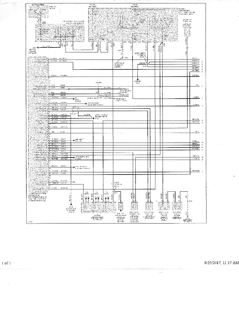

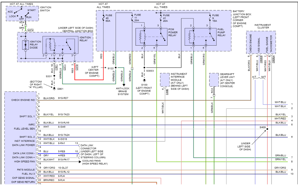

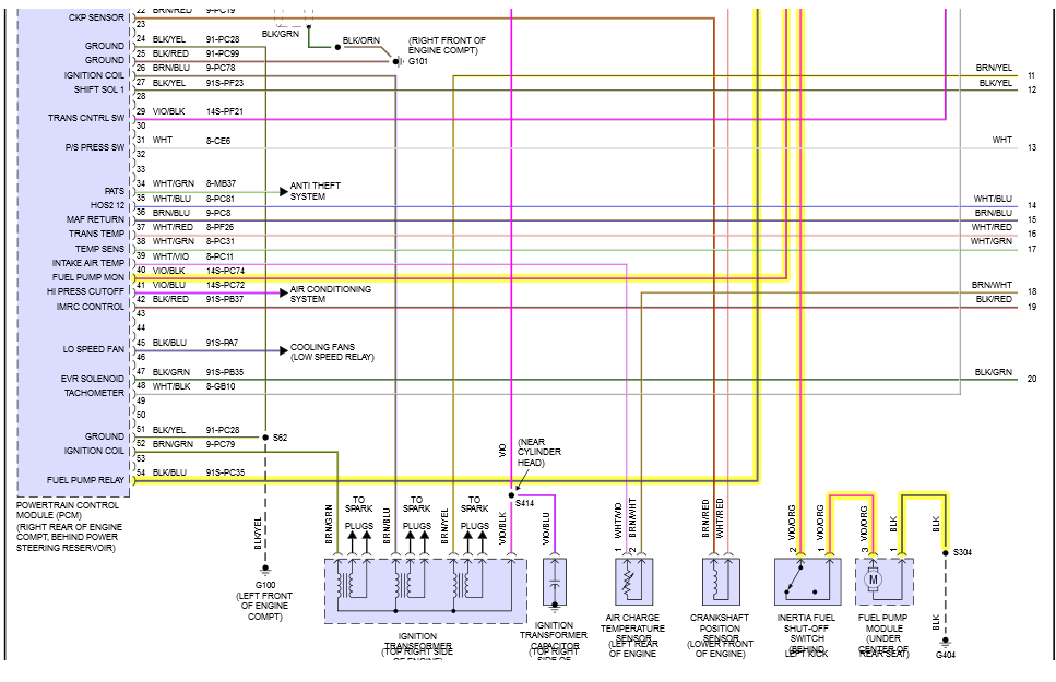

Does anyone have a Mitchell wire diagram for the fuel system on this car? Getting my butt kicked here. Thanks
9 years 2 months ago - 9 years 2 months ago #12317 by Chad
Replied by Chad on topic 99 ford contour 2.5 no start
Here you go.

9 years 2 months ago #12318 by Chad
Sorry about the poor quality... I'll try again.
9 years 2 months ago #12319 by Chad
Take 2.

Thank You so much! This has been a nightmare to diagnose especially with out a good diagram. This car has been sitting for a year. Just got it in. Had been a no start and went to another shop that put in a fuel pump.
I've got it now. The first thing I did was go to the relay. Relay has a constant + going to it. I figured The PMC was controlling the relay with a negative. This diagram confirms that. I am a little concerned that I activated the relay manually with no activity from the fuel pump. I used a UACTIVATE from aeswave.com and also hooked a low amp probe at the relay with no results. I think I am looking at multiple problems here. Thanks again for the diagram.
9 years 2 months ago - 9 years 2 months ago #12325 by Chad
Check fuse 14. When you activate the relay, does fuse 14 have battery voltage on BOTH test contacts? If it does, check/reset the inertia switch. Finally, check the Fuel pump ground.

I did check fuse 14 and it was good. Inertia switch was where I was going next. The only problem that I have at this point is I don't have the violet/orange wire on the fuel pump as described in the wiring diagram. Any ideas?
9 years 2 months ago #12328 by Chad
What colors DO you have at the Fuel pump? What colors at the inertia switch?

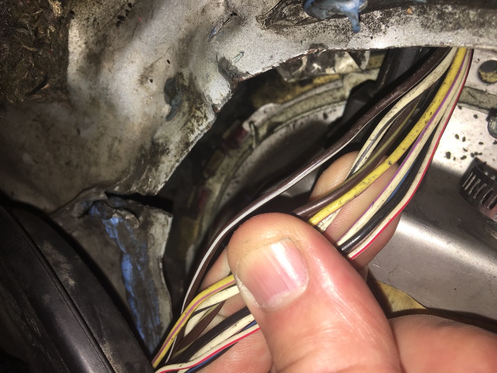

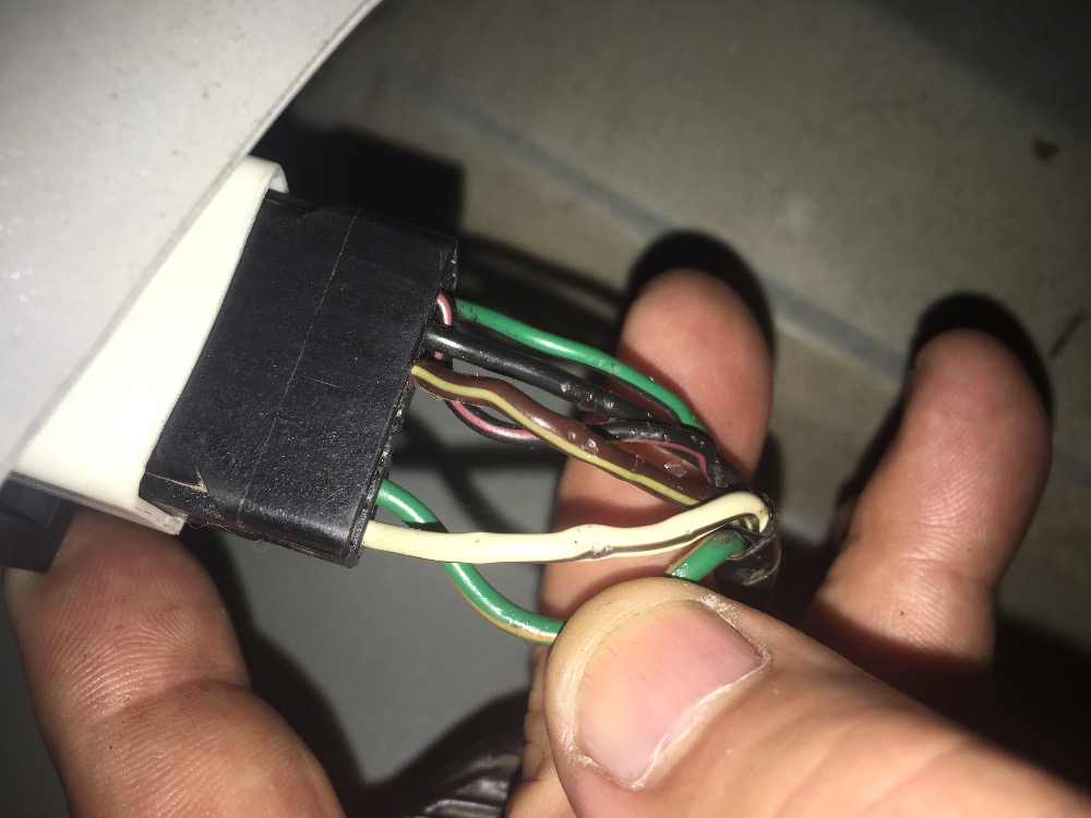

9 years 2 months ago #12341 by Dave101
Replied by Dave101 on topic 99 ford contour 2.5 no start
  • Dave101
  • Dave101's Avatar Topic Author
  • Show me what it's not!!
9 years 2 months ago #12342 by Dave101
These are the wires at the pump as well as the wires at the fuel module in the trunk.

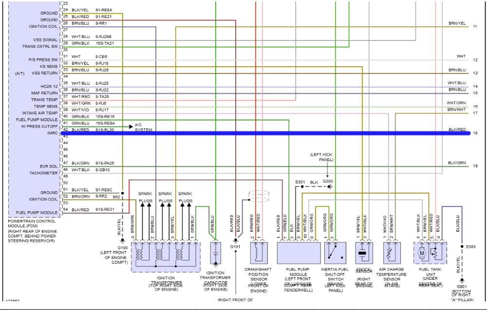

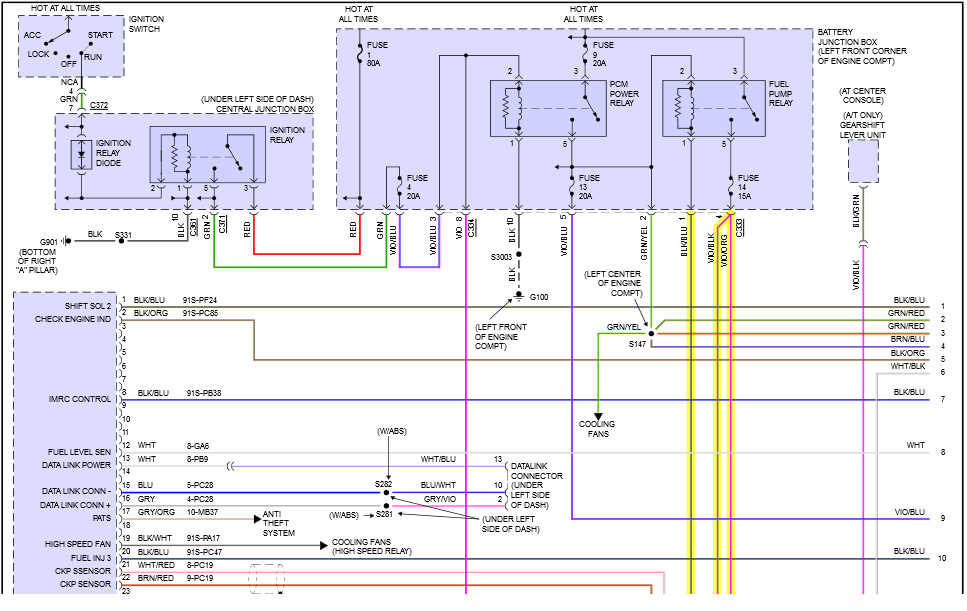

9 years 2 months ago #12343 by Chad
Ah. Try this one.
9 years 2 months ago - 9 years 2 months ago #12344 by Chad
Try again.
Last edit: 9 years 2 months ago by Chad.
9 years 2 months ago - 9 years 2 months ago #12345 by Chad
The following user(s) said Thank You: Tyler, Dave101
9 years 2 months ago #12346 by Tyler
Replied by Tyler on topic 99 ford contour 2.5 no start
Thanks, pole71! I was trying to dig up that same diagram, too. BBB Industries doesn't seem to have it. :angry:
Dave101, I'd suggest checking voltage at the white/black and brown/yellow wires at the module during cranking. These are the pump power and ground provided by the module. OR, you can check the green/orange and black wires for voltage during cranking. These are the module power and ground.
Either check will help point you in the right direction.

Thank You both for the information. It would have taken a lot longer to figure out what was wrong with this without your help. Just for my knowledge, what was the difference in the two diagrams?
9 years 2 months ago #12353 by Tyler
No problem! I think pole71 probably noticed the same way I did that your module connector had six wires, which means it's a Fuel Pump Driver Module setup. That first diagram had a conventional relay circuit with no module involved.
The following user(s) said Thank You: Dave101
9 years 2 months ago #12357 by Chad
Dave101 wrote: Just for my knowledge, what was the difference in the two diagrams?
Early or Late production. The First diagram was Early production. You, apparently, have Late production. Sometime in the production of '99 Contour, they added the module.

9 years 2 months ago #12406 by Dave101
Replied by Dave101 on topic 99 ford contour 2.5 no start (FIXED)
Guys thank you so much for the support and wiring diagram. This car had a broken ground going to the fuel module. It would have taken forever to fix if had not had a diagram. Thanks again.
