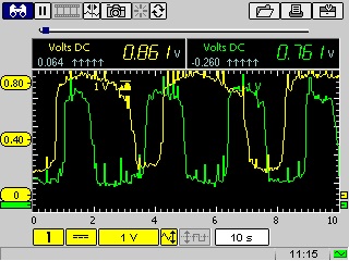

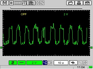

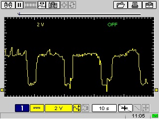

I've got the vehicle back and have put the scope on the O2's. The MIL is off at the moment but the same codes are still stored. The downstream O2's seem to mirror each other so I didn't take any scope screen shots of them. However, the upstreams are significantly different. Bank 1 (bank with the codes) seems to cycle rich-lean much slower than bank 2.
Here is my 'known good' bank 2 upstream sensor at about 2500RPM:
Here is my bank 1 upstream sensor at about 2500RPM. As you can see it stays rich while the other bank drops lean and back to rich in the same time frame:
Not sure it's helpful but here is a screen shot of both banks at the same time at about 2500RPM:
So, what would cause the O2 to stay rich like that on bank 1 for longer than bank 2? Long term fuel trim on bank 1 at idle is about +4.8 and short term is around 0.0. If I run the RPM up to 2500 the long term stays around +4.8 and short term goes up to around +7-10%, indicating to me a slight lean condition on bank 1 at higher RPM's.
It doesn't appear to me to be a vacuum leak. What would cause a slight lean condition on one bank and not the other that gets worse with higher RPM? The two items Paul always talks about are MAF and fuel delivery. There is no MAF that I can find. Could it be a dirty fuel injector? It is supercharged and I cannot find a MAF on this engine. Does anyone have any thoughts?

9 years 3 weeks ago #13818 by Andy.MacFadyen
Replied by Andy.MacFadyen on topic 2006 Mercedes CLS55 AMG O2 Sensor Codes
The two upstream sensors B1S1 and B2S1 control the fueling the downstream sensor are there to monitor that the catalyst is cleaning up the exhaust.
Even on a vehicle that has never had problem O2 sensors age and slow down and can drift out of calibration due to deposits and wear and tear and deposits on the internals of the sensor. An O2 is a tiny fuel cell which has a tiny internal catalyst on the surface of which a chemical reaction takes place. The other problem that can occur is the electric heating element or its supply circuit can fail this normally causes the sensor to take several minutes and higher RPM to start working.
After the engine is started from an O2 sensor has to warm up to come alive, when the engine reaches working temperature the ECU monitors the number of times the upstream O2 sensor signal crosses through 0.5v in a given time if after X minutes the crossing counts have not exceeded the required number the ECU flags up a fault code.
A sensor that has covered 100,000 miles will generally be serviceable have slowed down a little and the peak and minimum voltages won't cover as wide a range.

I finally got the car back into the garage and the next step was going to be a smoke test of the exhaust. Didn't even need to go that far. A visual inspection of the exhaust revealed the front weld on the right hand converter is cracked all the way around. It's not even attached anymore. I'm sure it wasn't that bad before as I can't imagine I would have missed such an obvious defect.
What's interesting about this exhaust leak is there is no soot around the crack and the car is nice and quiet. It's obvious it's the problem, though, and am hoping someone can weld it for him as I don't have a welder.
