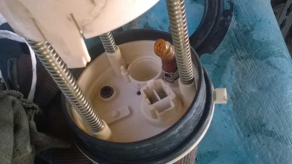

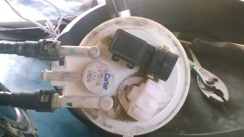

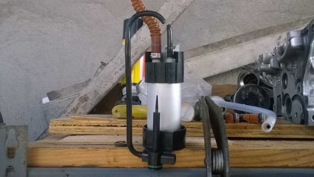

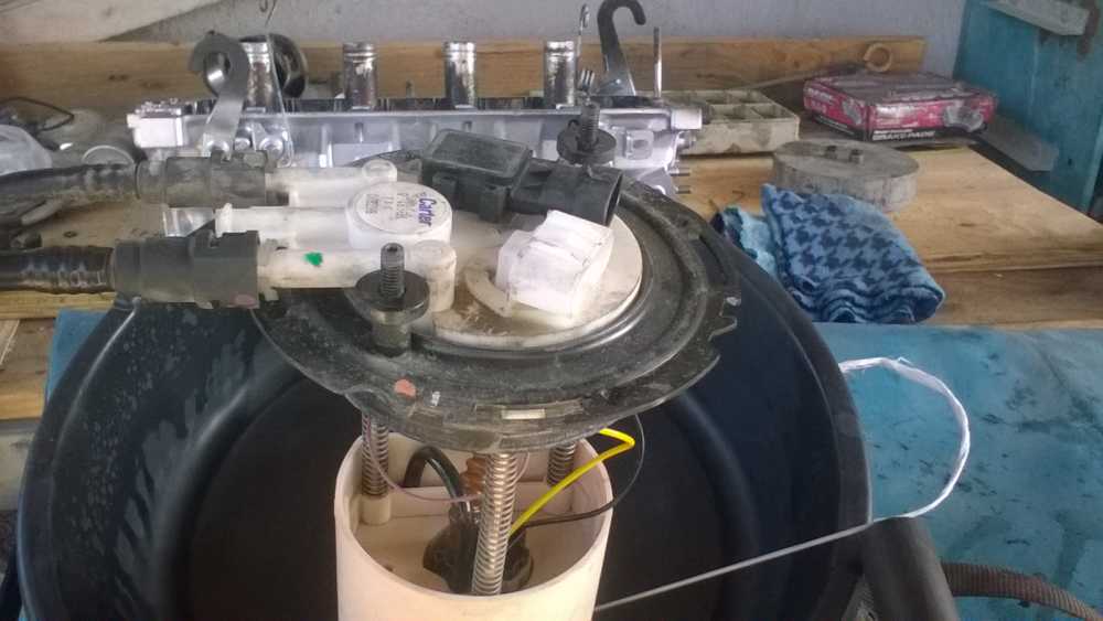

OK so i got this truck with the same symptoms the only difference is the year it's a 02.
Brother Tyler i did pinch off the lines and when the fuel supply line was pinched the pressure held.
Now by what i understand is the fuel pump check valve, in other-words it's the fuel pump it self or do i have to change the hole assembling?
Thank you for your help.
10 years 1 month ago - 10 years 1 month ago #1958 by Tyler
Replied by Tyler on topic 2000 Chevy Silverado 1500 fuel pressure
Hey Gilbert! Yep, if you pinched the pressure hose and got the pressure to hold, then you're looking at a pump check valve.
You're looking at a pump assembly in this case. To my knowledge, the check valve is separate from the motor and not available separately.
Last edit: 10 years 1 month ago by Tyler.
  • gilbert
10 years 1 month ago #1962 by gilbert
Replied by gilbert on topic 2000 Chevy Silverado 1500 fuel pressure
God bless you my brothers & sisters!
Hey brother Tyler can you point out which one is the check valve? I'm going to recommend the hole assembly but i would like to know.
  • gilbert
10 years 1 month ago #2055 by gilbert
The fix to this was replacing the fuel pump assembling the truck holds pressure and starts right up.
Thank you all your help.
