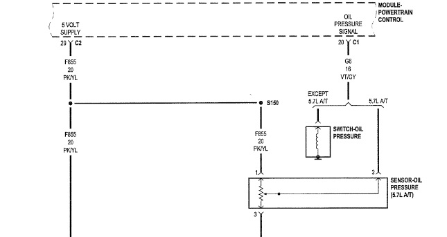

The oil pressure gauge and code are interesting... I have to wonder if the PCM you bought is incorrect for the truck, OR the programming isn't correct. Some voltage measurements at the oil pressure sensor could help answer those questions. For reference, I looked up the wiring diagram:
Backprobing with the key on, we're looking for 5V on the pink/yellow wire, something between .5V and 4.5V on the violet/grey wire, and 0V on the dark blue/dark green. Or with the sensor disconnected and the key on, 5V on the pink/yellow, 5V on the violet/grey, and 0V on the dark blue/dark green. Let us know what you find. ;-)

Ok reading from the oil pressure sensor pink/yellow wire reading 5.81 volts violet/grey wire reading 3.94 and dark blue/ dark green reading 0 volts
9 years 2 months ago #12572 by Tyler
Replied by Tyler on topic 08 Dodge ram
Thanks for the readings! That 5.81V is very strange - I can understand why the Dodge tech made note of it.

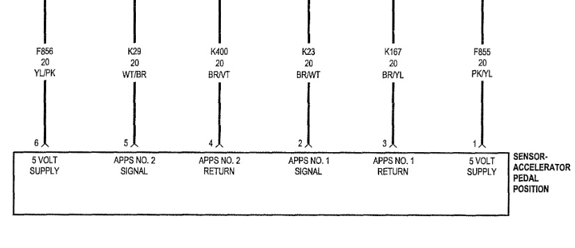

About the 5V reference circuit, there's a couple other quick tests we can do. Because it's an electronic throttle body, there's two 5V reference circuits at work. We know one is high, but knowing the health of the other would be valuable. From what I can tell, one 5V ref (coming from pin 29 of C2) feeds APP1, the crank sensor, the oil pressure sensor and the TPS. This is the one with 5.81V on it. The other (from pin 27 of C1) feeds the MAP, CMP, and APP2.
Probably the easiest place to measure both would be at the APP. It's the yellow/pink and the pink/yellow we're interested in.
Measure both with your DVOM and let us know what you find. :cheer:

Ok readings at the apps sensor are PK/YL 5.86 and YL/PK 5.01 going to check the grounds next. Do I change settings on the multimeter for checking the grounds.
