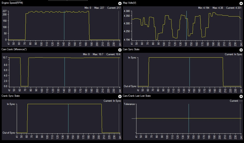

The PID for cam and crank sync reads "good" while running, but it read "not good" during start up.
Really? :blink: That's kinda interesting... Never seen one of these behave that way. This shot is from an '07 that wouldn't start due to no fuel pressure, and the Sync PIDs show In-Sync during cranking.
Wonder what those PIDs are doing during the long crank/no start. :huh:
