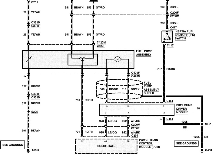

8 years 11 months ago #12783 by Tyler
Not to worry, these FPDM systems aren't that bad. ;-) Here's a shot of the wiring diagram for our reference.
It may look complex, but your list of possibilities is actually pretty short. One is a failed FPDM, stuck full fielding the pump. Two would be an issue with the Fuel Pump Command signal from the PCM, causing the FPDM to think the PCM wants a ton of pressure (unlikely). Third would be short to ground on the fuel pump control wire.
I think the best place to start might be with some multimeter measurements at pins 3, 10, 7 and 1 at the FPDM. Probably located in the trunk. Voltage and duty cycle measurements at those pins are what we're looking for. Do these with the FPDM plugged in, and the fuel pump running.
While you're there, you can do some quick resistance measurements across the fuel pump circuit itself. With the key off and the FPDM disconnected, test pins 3 and 10 for resistance to ground. There should be none. Or, use an incandescent test light connected to B+ on the same pins. Neither wire should light.

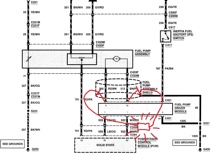

8 years 11 months ago #12817 by Tyler
Brocktoon wrote: Just double checking: I'm back probing pins 3 and 10, each with their own probe, laying the test light on them both and hooked light to ground?
No problem! Not quite... Sorry, I didn't describe that very well. :blush: I Painted over the diagram:
Make sense? Put another way, the test light is there to take the place of the pump as the load in the circuit.
The following user(s) said Thank You: Brocktoon
