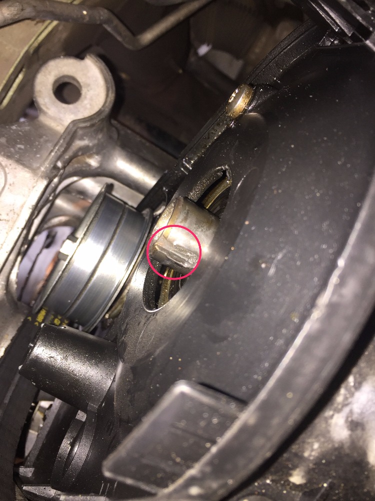

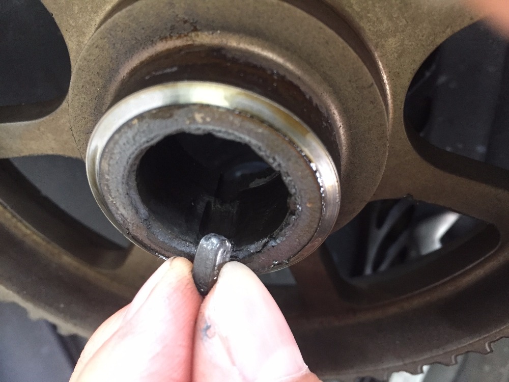

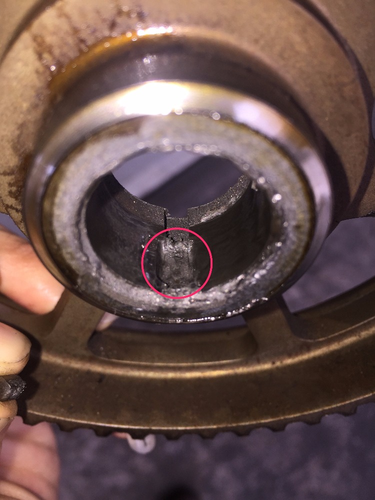

guys,problem is found.
the sprocket lock key was found worn out severely.(luckily it's still there,otherwise he will need an engine)
and the sprocket as well.
the camshaft looks like worn out as well.
i believe this happened due to a human installation error.(do you agree? coz the belt looks new)
they installed it according to the pulley sprocket marking,but the camshaft position was out.
that's why i thought the timing was good during the first check,i misjudged it. (my mistake)

8 years 11 months ago #13534 by Tyler
Replied by Tyler on topic vw beetle P0341
Holy CRAP. :woohoo: Stick a fork in that keyway, 'cause it's done! Nice job catching that one. B)
Possibly? I guess it would depend on if the camshaft sprocket was removed during the last belt service. Any issue with bolt tightness prior to removing the sprocket? Between this and the smashed CMP sensor, it sure seems like someone was having a rough time. :lol:

I'm not sure if the cam timing was off far enough in your case to show up on a vacuum gauge? Heck, given how loose that keyway was, the sprocket could have been shifting back and forth on the cam as the engine ran. :lol:
