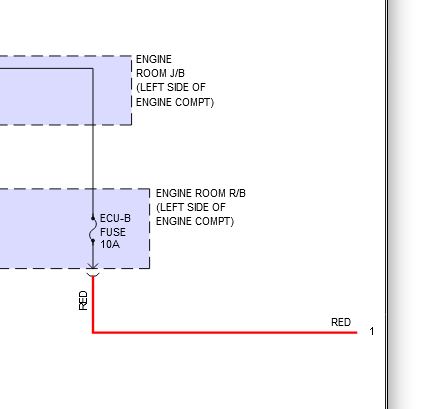

Check ECU-B Fuse (10 amp)

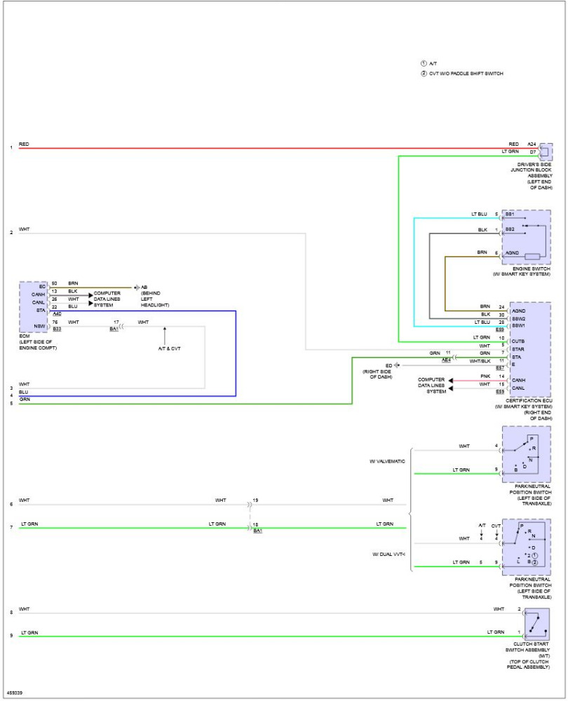

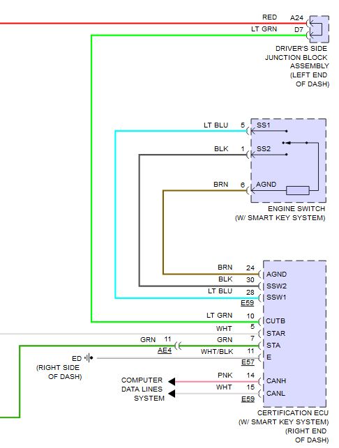

can i take a look at the complete starting system,my mistake is a toyota corolla altis 2015
8 years 11 months ago - 8 years 11 months ago #13520 by Chad
Replied by Chad on topic 2015 toyota corolla altis keyless entry
Last edit: 8 years 11 months ago by Chad.
  • Baraka
  • Baraka's Avatar Topic Author
8 years 11 months ago #13521 by Baraka
Replied by Baraka on topic 2015 toyota corolla altis keyless entry
is this the [push to start] diagram
8 years 11 months ago #13525 by Chad
It is and All-in-One diagram. With and Without Smartkey. Automatic and Manual transmission.

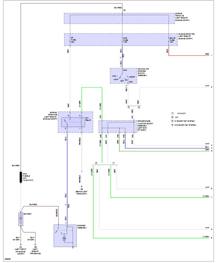

Pole I did a complete check on the starting system it all seens fine I think am having an IG problem can I have the complete ignition diagram IG relay and IG fuse ain't having power........
8 years 10 months ago #13755 by Chad
chuks.chigozie wrote: can I have the complete ignition diagram
It is 7 pages. PM me with your Email address.
