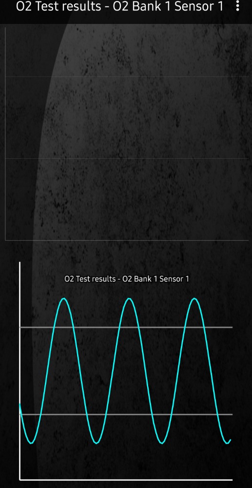

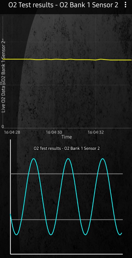

1 year 10 months ago #70993 by bills4065
I see what you mean- live data not showing on sensor 1. Can your scan tool tell you the voltage it is seeing on what looks like on your both graphs to be 2 switching narrow band sensors?
1 year 10 months ago - 1 year 10 months ago #71042 by Monde
According to Alldata, the front sensor is A/F and the rear, narrow band. If the front sensor reads 0v, I would expect the rear sensor to go richer as a result of the false lean condition in my opinion. Also, the sensor has a circuit that should not be ignored.

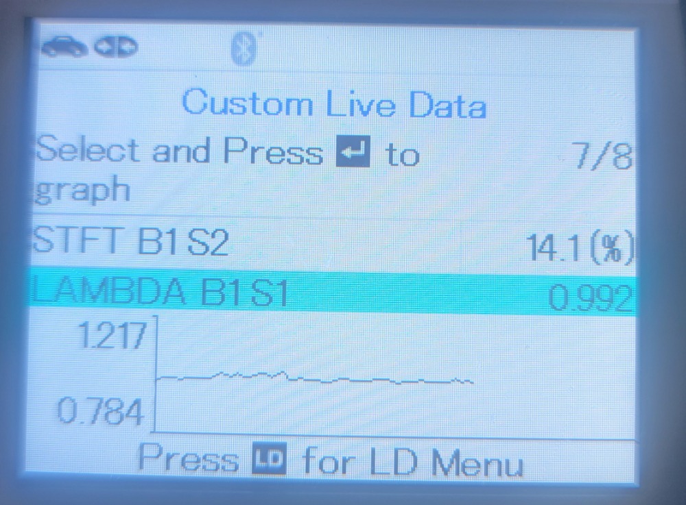

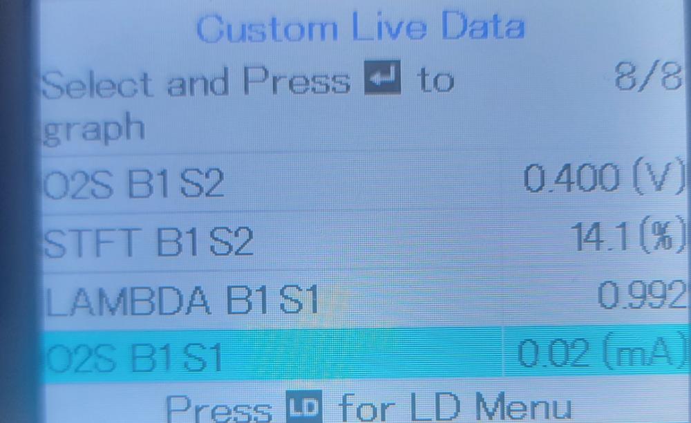

1 year 10 months ago #71143 by kimo.clyde
I think we're good. If this isban A/F sensor, here's the latest scanner data. What do you think?
1 year 10 months ago #71144 by Monde
A perfect lamda is 1, but 0.992 should be within the acceptable range. As long as you don't get a code, I think you are okay.
The following user(s) said Thank You: kimo.clyde
  • kimo.clyde
  • kimo.clyde's Avatar Topic Author
1 year 10 months ago #71145 by kimo.clyde
It actually went to 1.0 shortly after and stayed there.
