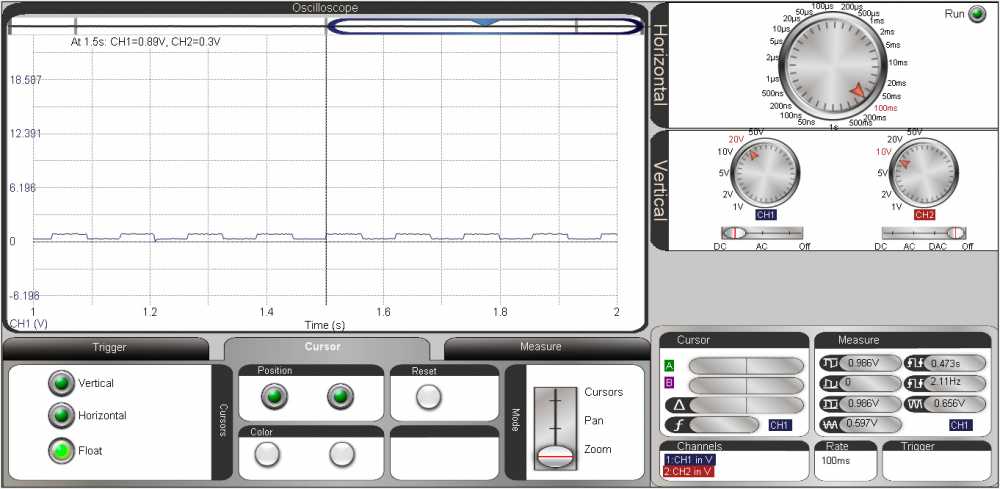

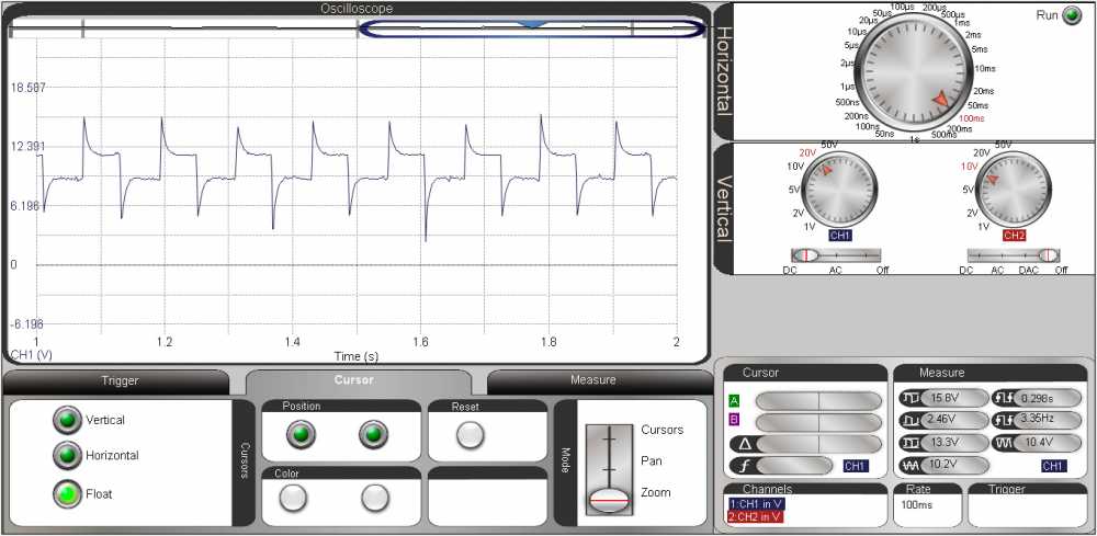

I had this 2005 Chevy Silverado 4.3 engine had a no start problem . I checked on the coil primary circuit signal and got a waveform , then i found the signal wire was open so i fixed it . But after the repair the signal waveform changed! I remember that it had something to do with the coil making a magnetic field or something similar . Am I correct or does the computer change the signal after knowing it had good connection? Does it apply on all engine coils?
Will post them waveforms . If someone could explain , in advance thanks!
This is with broken wire.
This after the fix.

Just for my info, was the truck running during your second capture? No offense meant here, but it looks like your scope didn't have a good ground at that time. The sharp positive and negative spikes followed by a curve are somewhat characteristic of that, seen it many times on my own scope.

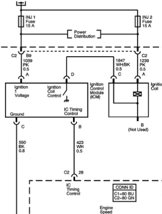

It might help me to answer your questions if I knew where exactly you were during these captures. Here's a diagram for reference:
Were you scoping the white/black wire between the ignition coil and the ICM, or were you scoping the white wire from the ICM to the PCM? Not trying to be picky, just want to make sure I'm on the same page.

I was backprobing on ICM connector "D" wire on you're picture. And forgot to mention it was cranking only on both pictures , and after I fixed it i connected a test light from coil post to ground. I remember that coil could be damaged if the spark had nowhere to go. And for ground had a jumper wire directly to battery negative post.
10 years 2 months ago #1316 by Tyler
Replied by Tyler on topic Question on a coil waveform!
Rukerin wrote: I was backprobing on ICM connector "D" wire on you're picture. And forgot to mention it was cranking only on both pictures , and after I fixed it i connected a test light from coil post to ground. I remember that coil could be damaged if the spark had nowhere to go. And for ground had a jumper wire directly to battery negative post.
Ooooooh, OK then, I take it back! The after waveform somewhat makes sense now, knowing that the spark is shorted out. You're completely right, 'deadheading' the coil secondary output can do damage. Good move by giving the spark an outlet.

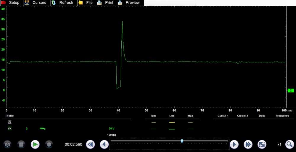

That 'taper' off after a spike also happens when the spark is shorted. Here's an example of a failed COP primary control waveform on a Jeep Compass:
The taper is there because the energy is getting bled to ground, instead of going across an air gap and creating a burn line in the waveform.

I believe the change in waveform has to do with the coil now building/collapsing a magnetic field, since you probably restored current flow through the coil with your wiring repair. You mentioned finding an open wire, where was it exactly? Your 'before' waveform suggests that it wasn't a complete open, necessarily, but high resistance in the white/black wire between the coil and the ICM.

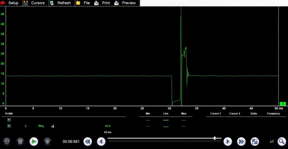

What you'd see in the case of a failed coil would depend on how the coil failed, exactly. An open or high resistance in the primary would look more like the first waveform. If you're a subscriber, there was a newer Premium video on a Nissan with a shorted secondary, great video:
For reference, with everything working correctly, the waveform should look something like this:

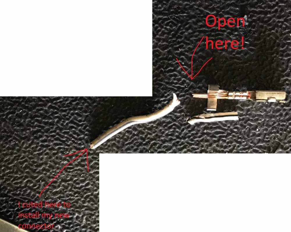

Ok thanks!!! So you suggest that if I cut the wire completely I would have seen a flat line ? And yes you are correct the wire was not all the way cut I'll post a picture of it tomorrow . It was kind of internal damage because you could not see it. The strange things is it did not have continuity with the volt meter but I'm sad I did not ohm the wire maybe I can still do it with the connector! I'll see what I find out tomorrow.
10 years 2 months ago #1356 by Tyler
Rukerin wrote: Ok thanks!!! So you suggest that if I cut the wire completely I would have seen a flat line ? And yes you are correct the wire was not all the way cut I'll post a picture of it tomorrow . It was kind of internal damage because you could not see it. The strange things is it did not have continuity with the volt meter but I'm sad I did not ohm the wire maybe I can still do it with the connector! I'll see what I find out tomorrow.
Correct, if you cut the wire you'd end up with zero activity on that circuit. Really, that's pretty much what you had in the first capture, but apparently there was some kind of connection in there, 'cause you can see around 1V available when the coil driver is off. Great find, by the way! B)

Here is the wire I found to be bad!
One last question , should I post questions here about waveforms? Or somewhere else? I still have a ton of questions about waveforms and I will be getting a lot more of them at work! Thanks a lot!
10 years 2 months ago - 10 years 2 months ago #1376 by Tyler
Ahhh, right at the connector, nice. Did you end up repinning that connector?
