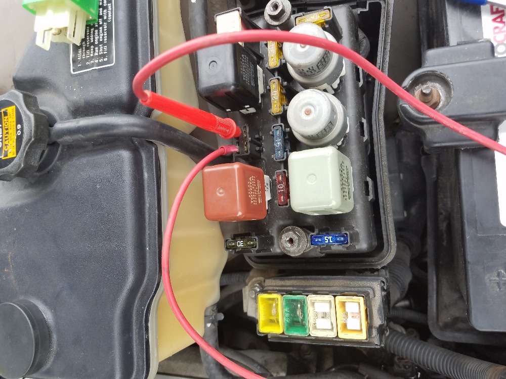

Now it wont start or even turn over. Found a blown 15A fuse for security system/shift lock & replaced it. Reset the alarm, and still nothing.
Bypassed relay and supplied direct 12v to starter wire under relay. No reply. Now the security system is unresponsive. No alarm, no red light, nothing.

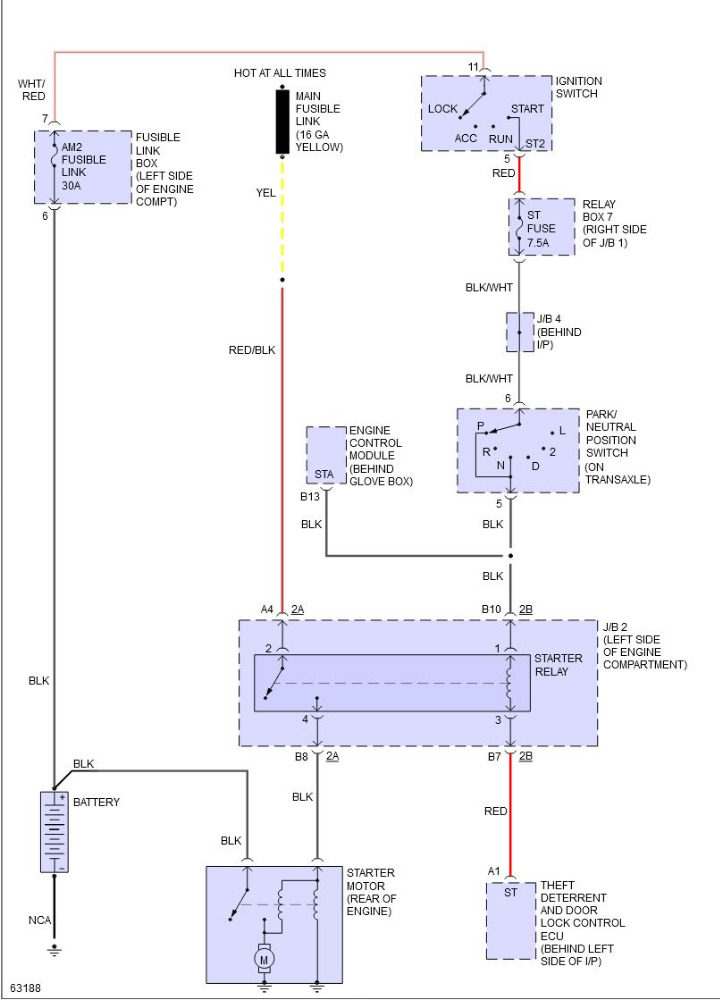

- Posts: 2222
9 years 3 weeks ago #13883
Replied by Chad on topic Lexus LS400 No Start
- Vettefan77
- Posts: 4
9 years 2 weeks ago #13890
by Vettefan77
Replied by Vettefan77 on topic Lexus LS400 No Start
Thanks for the diagram!
Where did you get it? And are you sure its for a 94??

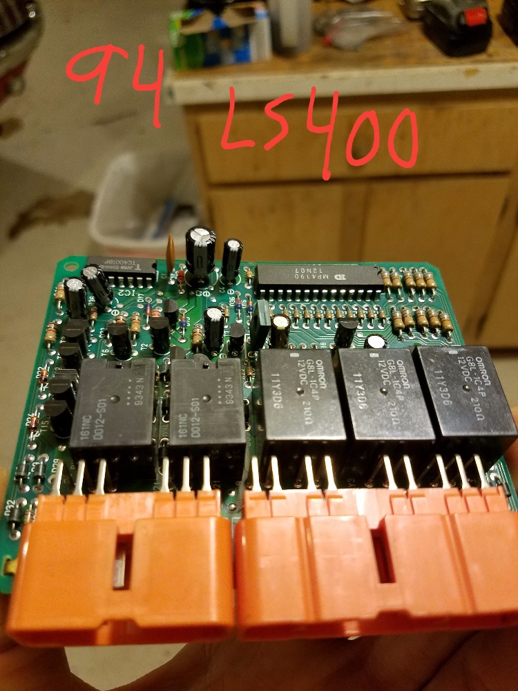

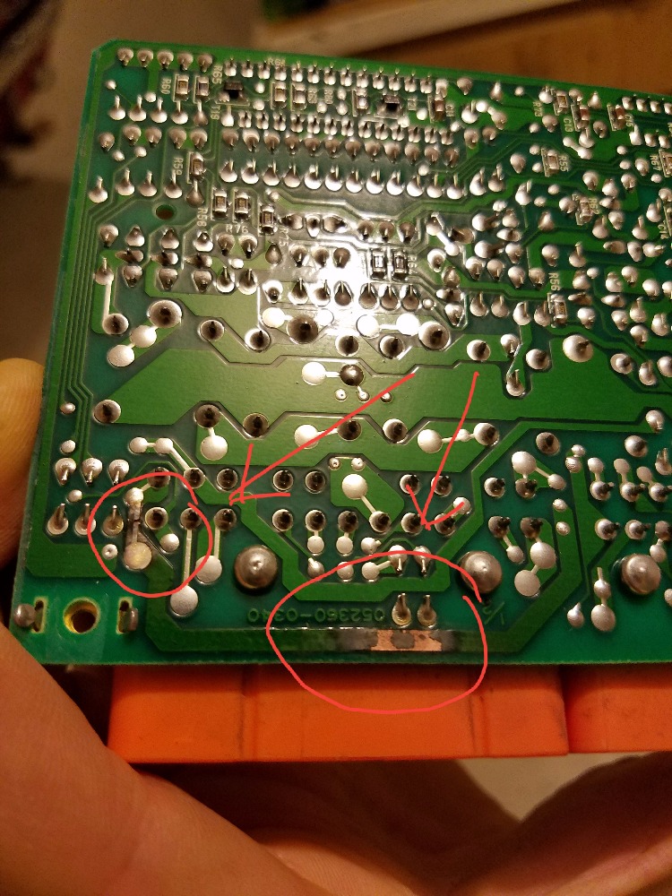

Removed anti theft ecu and inspected circuit board. No leaky caps, but the main bus is toast:
Seems odd, but we also noticed that the AM2 fuse in the main fuse block is a 60 amp fuse when it should be a 30 amp.
I thought AM2 was for ignition only....could this be my no-start gremlin?

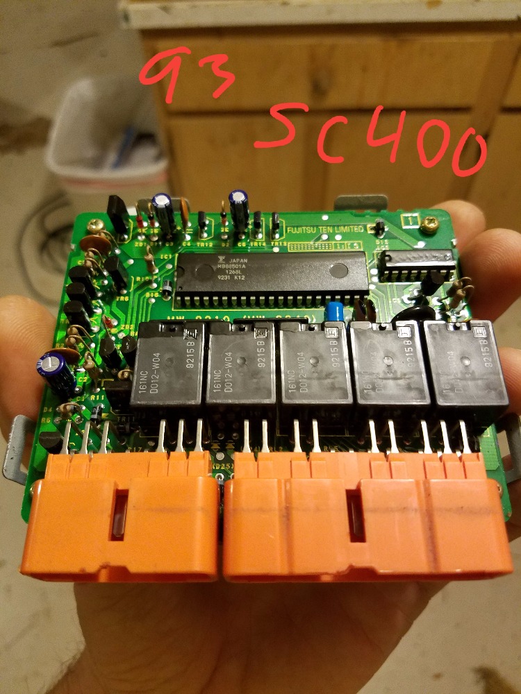

Also, replacement theft ecu is out of a 93 sc400. Boards look completely different, but plugs and pinout are identical:
This should work right??
