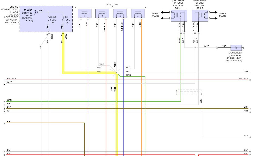

I have a problem where the Evap canister solenoid (at rear of car) was suspect - couldn't fill up the tank and check engine light was on. I used an old fashioned voltage tester and I had 12 volts dc on one of the connector pins but no voltage on the negative pin. I'm under the impression that the light-up tester should have a dim light on the negative side (PCM) when the key is on and the sensor is connected to voltage. I had no voltage at all but mistakenly left the tester hooked up to 12 volts and touched the negative wire to a known ground. The car would not start after I did that. The OBD shows DTC error. Was I lucky enough to only have blown a fuse or is the PCM ruined . Yes the battery was hooked up when I worked on it. If there is a fuse. Where is it. All answers appreciated.

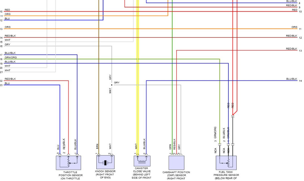

ScannerDanner uses a power probe to test in this video, but the procedure is the same for an incandescent test light. Notice that the connector is STILL CONNECTED to the solenoid during the test. The voltage that is read on the negative side is voltage that came through the windings in the solenoid....in from the power side, though the solenoid, to the ground side. You can see the voltage and the ground side because there is no ground.....until the computer commands the solenoid "ON" by providing a ground to the circuit.

It looks like the solenoid shares a fuse with the injectors. Check the engine compartment Relay & Fuse Box. Look for the 15 amp INJ(ector) Fuse.

To clarify, though, the reason the fuse blew is NOT because you tested with the connector dis-connected. It is because you shorted the power wire (WHT) directly to ground, WITHOUT any resistor. I.E. the test light element, or solenoid windings. Even with the connector plugged in, back-probing the power feed to ground, with out a resistor, will pop the fuse.

Hi: I made the poor assumption that the white wire was negative. Thanks to the schematic you included I now see that clearly. Have a good day.
