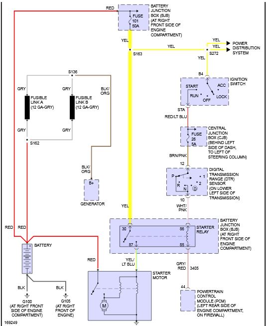

After watching your video How to troubleshoot a starting system (bad ignition switch) - Dodge Neon I have a Question: I recently bought a 2003 Lincoln Towncar 69k miles garage kept. nothing was wrong the first 1200 miles... then one day no crank no start last week I changed out my ignition switch thinking that was the problem ...(electrical side) under dash on column only $20 it was not the problem . I also can crawl under car and jump the starter off the positive post of starter to start post so i know starter battery and solenoid work that is why i changed ignition switch. ( I also removed starter and had it bench tested at the auto parts store (works fine only 69k miles on it) and then reinstalled) when I pull out the starter relay under the hood in fuse box and put a test light in terminals after checking ground and making sure light works ( it did) There is no power in any of the 4 pins of the relay terminal and when in run and crank position there is no power in any of the 4 pins in the terminal . Does this leave me with a PCM problem because that controls neutral safety and starter signal? I have checked all fuses and all working . The dash cluster warning lights also do not light up when key is turned to run and there is no security light flashing in cluster. However the flashing light for security does shut off after 3 seconds like it is supposed to on the dash when key is in run right before crank position. please help me confirm it may be pcm , Thanks Rich

8 years 10 months ago #14135 by Chad
Replied by Chad on topic 2003 lincoln towncar no crank no start
In the Battery Junction Box, Check Fuse 101. It is a 50 amp fuse.

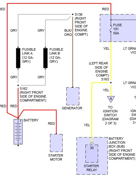

8 years 10 months ago #14140 by Cournoyer
Replied by Cournoyer on topic 2003 lincoln towncar no crank no start
thanks , i am going to check for an open in the yellow line because the fuse is good #101 50 amp could you post the other diagrams it said 2 of 3 different diagrams

8 years 10 months ago - 8 years 10 months ago #14142 by Chad
Cournoyer wrote: does those other diagrams show the pcm coming into the yellow line near the ignition switch?
No.
With the starter relay removed, there should be 12v terminal #30. If you have no power here, the problem is BEFORE the ignition switch.
Last edit: 8 years 10 months ago by Chad.
8 years 10 months ago #14143 by Chad
And, if there is no power on terminal #86, with the key in the "START" postion, I would say, the problem is BEFORE splice s163.

8 years 10 months ago #14293 by Chad
Cournoyer wrote: (is there supposed to be power at #30 with key in run )
Yes. #30 should have power all the time.
when i check the power on the start post solenoid wire down by the starter I get 11.4 volts in start position with it not connected to the solenoid . when i connect it i get less than 1 volt while in start position on the key
This suggests high resistance in the yel/lt blu solenoid wire. Check the connection at the relay and the solenoid. Possibly, corrosion inside the wire coating. To rule out a shorted solenoid , you could hook up a head light, or some other electrical load, in place of the solenoid.

8 years 10 months ago - 8 years 10 months ago #14297 by Chad
Cournoyer wrote: how can my solenoid be bad if i can jump it with a wire to that battery positive and she starts right up?
Good point.:whistle: Lol
if i pull out the relay can i jump 86 to 85 and 30 to 87 and try to start the car
30 to 87, yes....86 to 85, NO!
is there any way the pcm is involved with this problem
Pin 44 of the PCM Should supply a ground to the relay. If it is, then the PCM is not the problem. A way to test everything else involved would be to ground pin 44 by back probing the PCM.... With the key in the start position and the gear selector in Park or Neutral, Pin 86 of the relay should have power. The computer grounds pin 85. The relay closes. At this point, you should have battery voltage on pins 86, 87, and 30. Pin 85 should have a ground....the starter should be cranking.

8 years 10 months ago #14305 by Chad
Yes. It should start. I mentioned grounding pin 44 only for informational purposes. I, really, don't think the PCM is the problem. You have a major voltage drop on the solenoid power feed. This is where we need to concentrate. To cut to the chase, if there is power at the 50 amp fuse and you pull the relay and jump 30 to 87, the starter should crank. End of story. However, your voltage is dropping from battery voltage to less than 1 volt. We need to find WHERE it is dropping.
