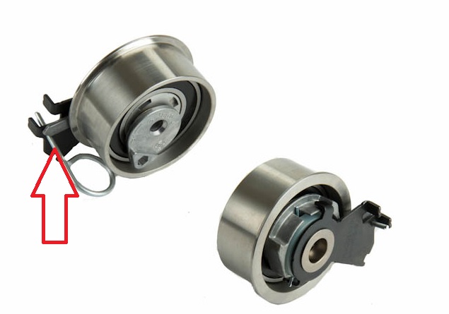

8 years 10 months ago #14215
Replied by Tyler on topic 2003 Hyundai Elantra Water Pump and Timing and Belt Installation Aftermath

8 years 10 months ago #14228
by scarney
Replied by scarney on topic 2003 Hyundai Elantra Water Pump and Timing and Belt Installation Aftermath
Not quite. It doesn't have the thing on the side. It just looks like a regular pulley.
