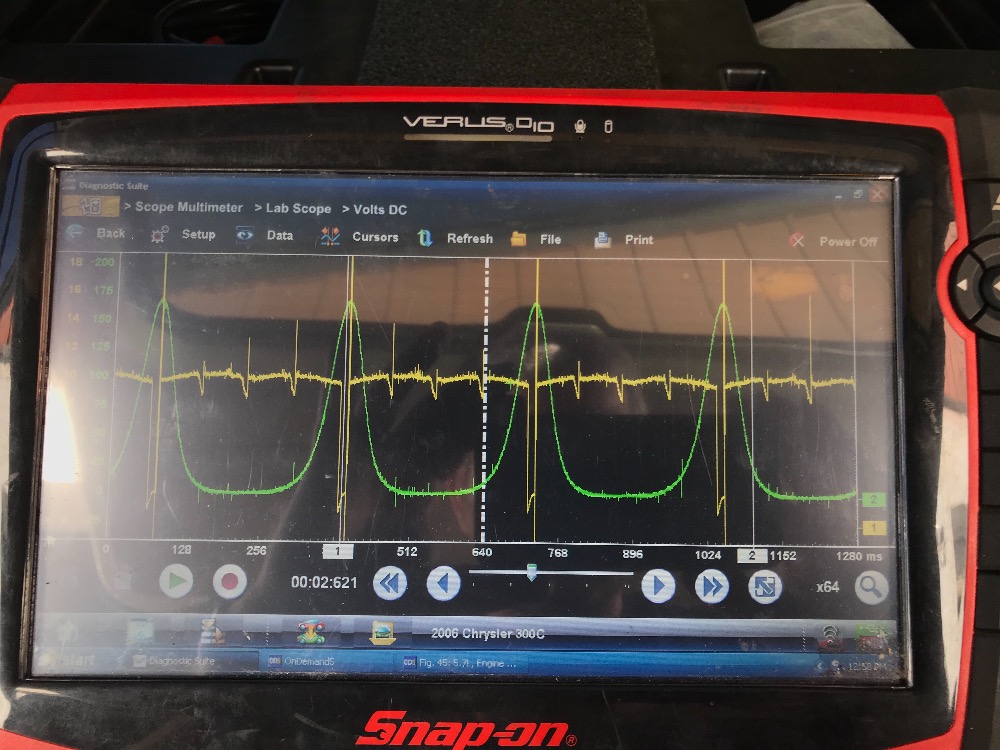

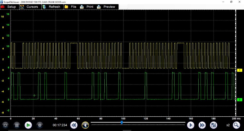

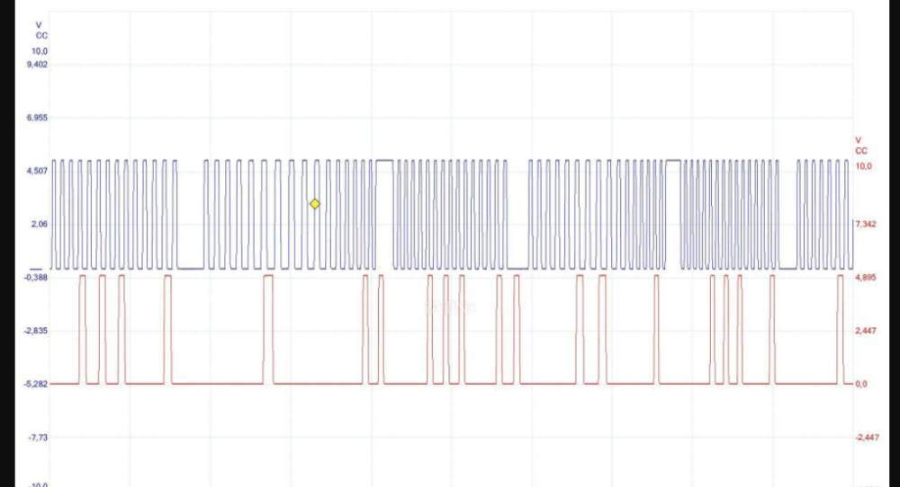

Good Morning everybody! I was wondering if anyone on here has a known good cam/crank waveform for a 2006 Chrysler 300 with a 5.7 L.
If anyone does and could share I would appreciate it very much.
Thanks!
Nandor

Replied by Nandor69 on topic 2006 Chrysler 300 5.7 Cam/Crank waveform
Well that’s better than nothing. I’ll see how it matches up to this one. I know there is a possibility it’s not the right one but I’ll see

9 years 1 week ago #14232
by Nandor69
Timing chain broke right at tdc.
