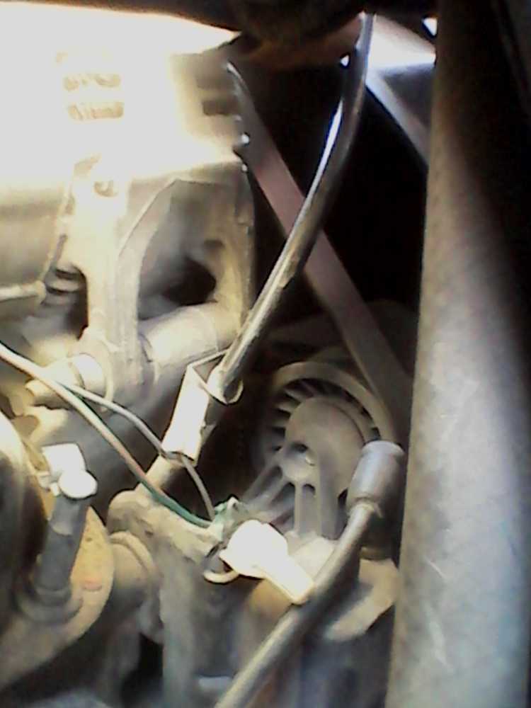

On Sunday the 14 the van started then turned off and would not start after. I checked for spark and had none at coil wire . The tip of the coil was rusted and so was the the wire i cleaned them then i checked for power with a test light.
I had power on both wires at this time i had not put the coil wire so i did put it back on and it started right up.
This Sunday same thing start then stalled so today all i did was checked for power with a test light and the van started right up. I brought it home to work on it i pulled the wire diagram and the dk grn/org pos. goes to the injectors and alt. The gry wire goes to PCM ign. coil driver . Do i have a bad driver or can it be the crank sensor . THANK YOU FOR YOUR HELP.

Is your second picture on the passenger side of the engine, looking forward? Or, are you suspicious of the wiring repairs?

I wish I knew :unsure: Any possibility of a poor connection or spread pin at the coil connector? That may explain why it comes back to life only during testing.

Brother the first time I also thought it was a bad connection as you can see the wire's have caps. When it happened that went out the window.
On this van it starts then it turns off after about a min. then no spark that's when I put test light to ground and check for power and it turns on. I hope that replacing the coil and crank sensor took care of that we need the van. Yes brother I have seen that thread .
