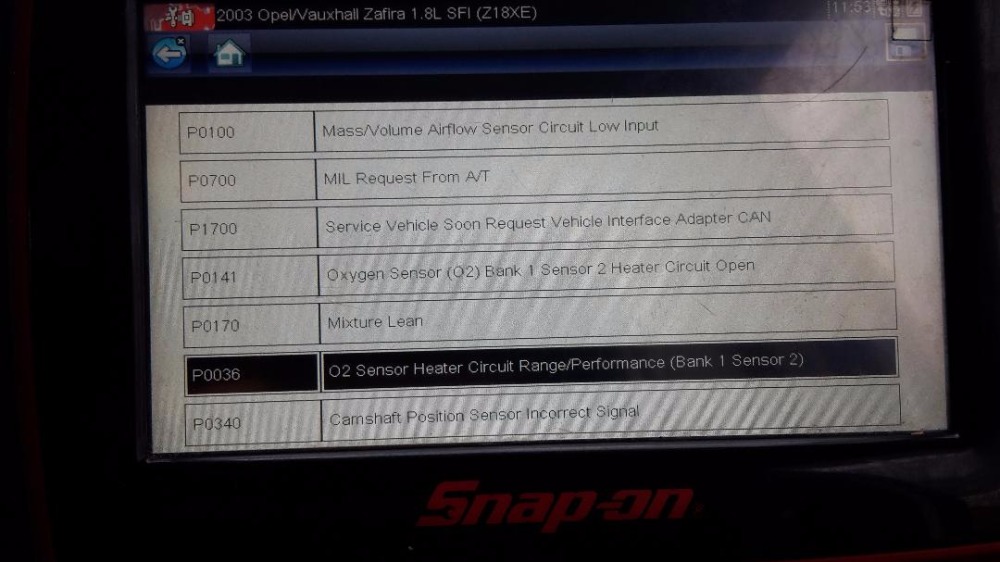

A friend of mine, running a small garage had requested me to look into a Vauxhall Zafira 1.8L, 2003; Engine code Z18XE. The symptoms were; Extreme loss of power and very poor acceleration in most of the driving time and it can be as bad as a maximum of 20 mph vehicle speed.
The attempts to fix the car went as follows:
* The garage owner (My Friend) had accepted the customers request to replace the Mass Air Flow sensor (MAF) based on a fault logged by the ECU, as he was badly in need of using the car. Two days latter the customer informed the garage that the loss of power was so sever that he was unable to bring the car to the garage.
* On behave of My Friend I went to the customers place and retrieved some DTCs (shown by the attached photo) and based on the symptoms; the one that caught my attention was the P0100 and the live data for the MAF was the next check which was an idle signal of Zero volt (Exactly 0.06V) and a maximum of 2.0 Kg/hr (about 0.55 g/s). This is far from the expected idle value. Basic checks on the wires did show no physical damage, but during this the MAF signal did jump to an acceptable range of 0.6 volt. This enabled me to drive behind the customer and follow him to the garage; were a detailed checks on the wiring sub loom was carried out to confirm no wiring damage. This time the signal voltage stayed at zero and I told My Friend that I don’t know the cause of the symptoms; either more time is given for further checks or We say We don’t know.

Hello, did you checked MAF signal with a scope and compared against scanner data pid?

So you say the signal you have does not match with air entering the engine !? What you have and should see next, is if the MAF has 12volts and ground using the voltage drop test.
If everything is fine you should make a bypass to the signal wire with the test light connected from battery positive to the signal wire, signal voltage should increase. You must know what you doing or can damage ECU.

If you say the wires are ok, so you must have a bad contact on the MAF plug, ECU plug or ECU internal pins. With engine running and checking voltmeter, move plugs and cables to see if same thing happens, check power/fuse to the MAF for bad contact...very common is bad pins contact on plugs!
The issue must be there to test or make it happen. Do not guess, test!
