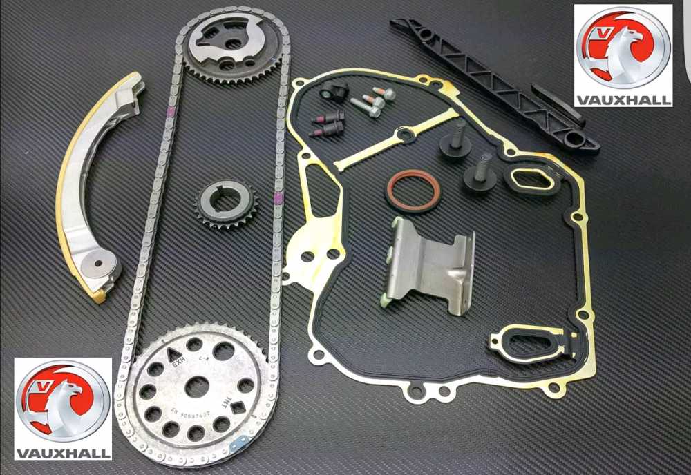

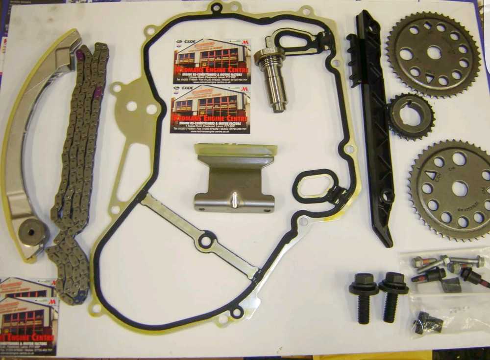

Both kits for this car are the same in every way apart from the exhaust cam gear, although I'll double check this. I was sent the wrong one. I have attached photos of both kits. You'll notice that in one kit the cam gears are the same. It was this kit that was sent to me. The other kit has a very different looking cam gear, much thicker looking! This is the correct gear. You can actually tell by the machined surface by what this gear does.

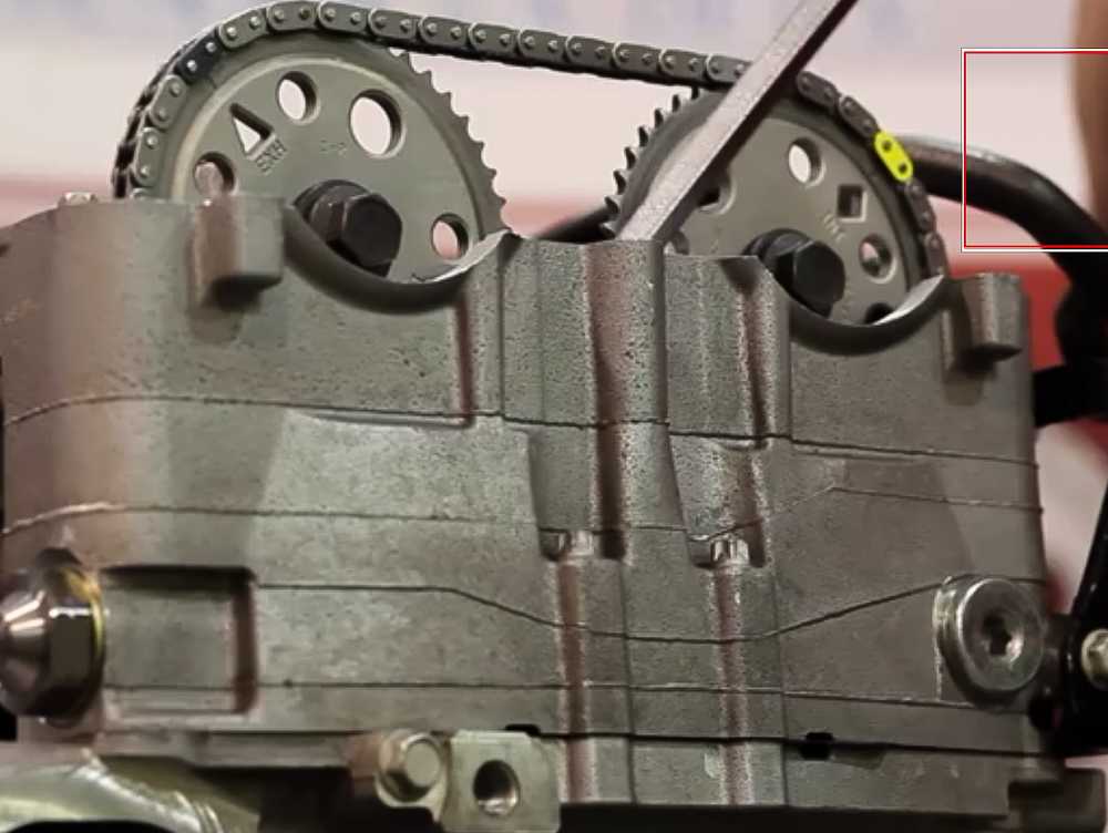

I've taken a screen grab of the other variant of this engine so you can see where the confusion was. This is from a video that's on YouTube. I hope it's ok to post this.
10 years 2 months ago #1487
No problem there, sir!
Always easier to see the differences in hindsight, right? I'm bad about comparing parts carefully before installing, gotten myself in trouble many times. Why do I never learn :lol:
Replied by Tyler on topic No cam signal on a good working circuit P0340
Paul_Kilgour wrote: I've taken a screen grab of the other variant of this engine so you can see where the confusion was. This is from a video that's on YouTube. I hope it's ok to post this.
