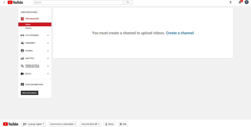

I am working on finishing up my first timing belt job on a 2003 Hyundai Elantra. I am having trouble where the belt is walking either towards the engine or away from the engine. Does anyone have any tips, I am really stuck on this one. Best bet is to check out my YouTube video where I explain the problem. www.youtube.com/edit?o=U&video_id=KFzBk840rN4
I can get the belt walk toward or away from the engine, anywhere but right in the middle. If the belt walks towards the engine, it seems to be scrubbing a bit against a flange on the back side of the tensioner. If it walks away from the engine, it seems like it might okay, since it's blocked down beneath by the crankshaft pulley. I really need some help here. Thanks.

If you past the video id in the YouTube search bar it will come up
KFzBk840rN4

I think this link should work. The other link was the link from the video section of my account.
Steve
