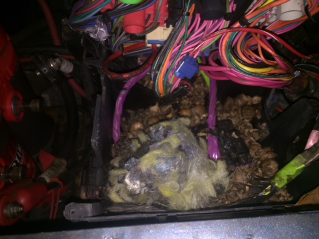

Mice living in the UHBEC, MAP airbox, inside the dash & A/C Evaporator housing (nest plugged the drain and the tray filled with water) and somewhere under the seats. They chewed insulation on a couple of the wires underneath the UHBEC and I couldn't find any other chewed wiring. I repaired the damaged wires and the only DTC it's throwing is P0336 (Crankshaft Position Sensor reference circuit performance). The truck ran after draining the evaporator tray. Started the truck moved it 150 feet. Parked it and hasn't started since. Talked with a friend who is a mobile service tech and he thought since it didn't show any RPM indicator when cranking that the CPK was defective. Towed it into my garage and replaced the CPK .... STILL NO START same P0336 DTC. Over the last four weeks I have trapped 4 mice inside the cab and have traced the CPK wiring (all OK). Bought new Autel MAXIdas 808 Scan tool to assist with running the flow chart from Mitchell DIY and the diagnostic chart for the Crank Position Sensor. The only discrepancy I've found is that the 12 volt reference circuit to the CPK shows a voltage drop of 1.5 volts at the PCM output. STILL NO START. Mitchell DTC chart says that PCM needs to go.
What am I missing??

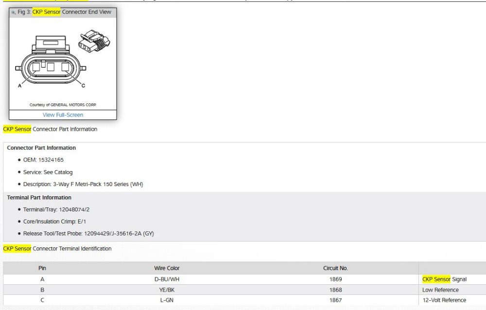

im looking at a wiring diagram do you have a purple/white white/black and gray and black wires at the crankshaft sensor?? you should have a 5 vols on the purple/white wire. a ground on the white/black wire. and a signal on the last wire its either a pull up or pull down design.
  • Scannerdaddy-o
  • Scannerdaddy-o's Avatar Topic Author
8 years 11 months ago #14713 by Scannerdaddy-o
Hi Cheryl, My harness is coded differently. My Ltgrn=12v ignition. dkblu/wht= CKP signal, yel/blk=5v ref. Ltgrn shows 10.9v at the PCM output and the CKP sensor input. Still no crnk.

8 years 11 months ago - 8 years 11 months ago #14746 by Chad
According to Mitchell, the yel/blk wire should be LOW REF (ground).
Cheryl, I believe, you are looking at the 6.2L

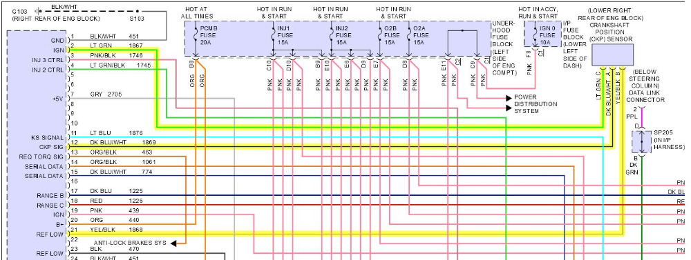

Hi Pole71
The ground on the yel/blk is good at Pin 21on the PCM. The ltgrn shows 12.03 at the Pin 2 on the PCM and 12.9 at the battery. The dkblu/wht does have varying voltage between 2.3 and 4.6 volts while cranking. Still stumped.

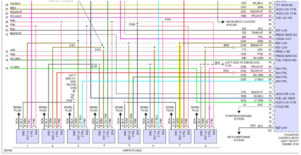

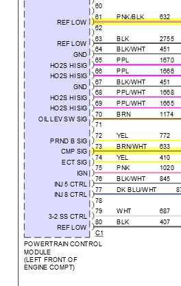

Since you can't access the CMP sensor, here are the pin locations and colors for the CMP signal and low ref.
The RED wire on pin 39 of connector 2 is the IGN FEED.

8 years 11 months ago #14840 by Chad
Have you checked power and ground at the coils?
