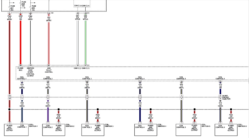

they are 2 wire coils. the power feed comes from the asd relay for all of them. you can use an amp clamp around the feed wire for all the coils. and look for a pattern that is different from the rest. (paul has videos on how to set it up) specifically on a ford expedition... also I would do a clear flood mode crank first thing. (foot all the way down on gas pedal while cranking) and listen for a consistant crank.
10 years 2 months ago #1514 by Tyler
Replied by Tyler on topic 2014 Grand Caravan 3.6L P0304
Hey Chris! I was able to dig up a ignition system diagram, for reference:

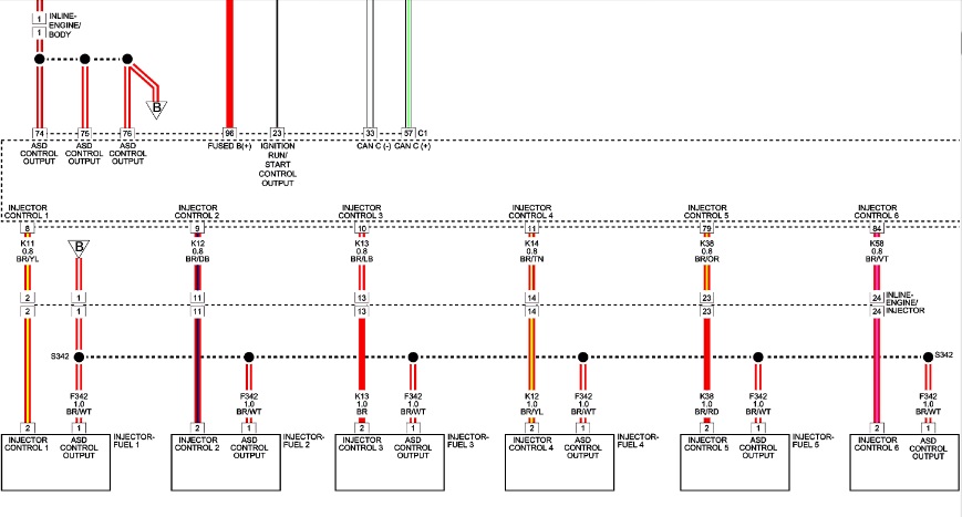

Here's the injectors, too, just because:
Good ol' two-wire coils on this one, nothing fancy. Second thing I see is an 'Inline-Engine/Injector' bulk connector in both diagrams. I think that'd be an ideal place to connect up for all six cylinders, assuming that the connector is easily accessible. Easy ignition primary voltage and injector voltage testing.
Not trying to color your diagnosis at all here, but there is a recall/campaign/TSB/whatever out for cylinder heads on these engines. Or, are you already going in that direction?

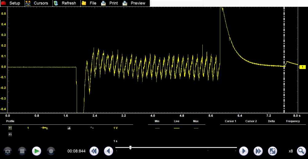

If you're interested, relative compression is still an option with your scope. No low amp probe required. Here's a shot of a relative compression test I did on my car recently:
Settings are in the lower left, 1V scale with AC coupling and filtering on. The scope leads are connected to battery positive and negative. Not sure how the Hantek works exactly, but it may be worth a try?

I'm not sure if you saw the injector diagram I posted earlier? Pin 14 is the #4 injector control wire, brown/yellow on the engine side, and brown/tan on the computer side. The #3 injector control wire is right next to it, pin #13 brown, for waveform comparison.

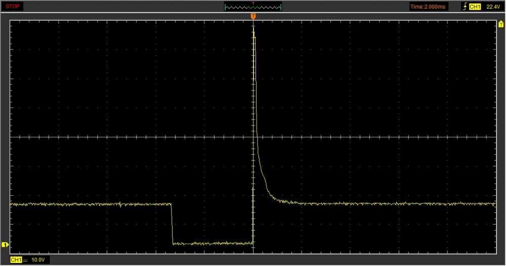

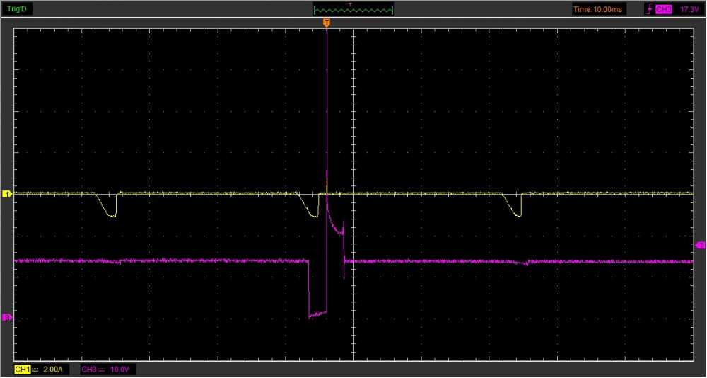

Yep, finally identified the right pin and got a waveform from it, which looked fine, (I think I can make out the pintle hump). I attached images of the waveform as well as one I got from the control pin of the #4 coil. Both of these waveforms look to be the same as others I looked at.
It is still a definite misfire, still has the shake and the trouble code came right back after clearing the codes after changing plugs. Did a relative compression test and all the humps look to be the same height, none are missing. So if I got compression, got pcm control for the coil, new oem coil installed, as well as plugs, the injector looks to be working. Only thing I can think now would be a dirty injector? Could run cleaner thru it (the one that connects to the fuel rail and engine runs off it) but really that is not 100% successful either. We have an OEM injector on the bench from the dealer, so can put it in, would like to have a confirmation that it is faulty tho, but at this point what else could it be?
Coil control signal with the upside down current ramps
