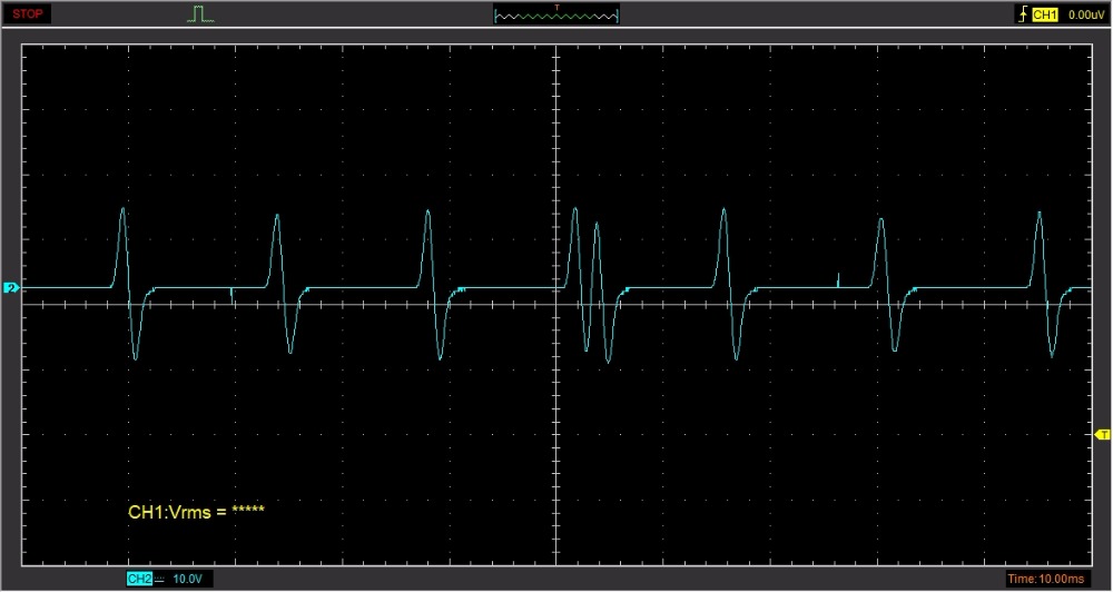

GM 3.4L crank sensor glitch?
- Wadmancpu
- Posts: 6
8 years 11 months ago #14858
by Wadmancpu
GM 3.4L crank sensor glitch? was created by Wadmancpu

Replied by juergen.scholl on topic GM 3.4L crank sensor glitch?
This looks like anormal VRS signal, probbly not every 4th but every 7th spike is different. Your time base is at 100ms total screen, I suppose there is just one crank revolution to be seen. So this accounts for something less than 200 ms for a complete cycle (720 deg.) and then it would be taken while engine idling...
To be sure It will be necessary a picture where the supposed "glitch" is to be seen at least twice within one screen shot.

Replied by Wadmancpu on topic GM 3.4L crank sensor glitch?
Ok, what causes the 7th spike to be different? I have a hard starting issue with a misfire at idle.
The seventh spike is caused by an additional notch in the reluctor. Its function is to identify crankshaft position.
