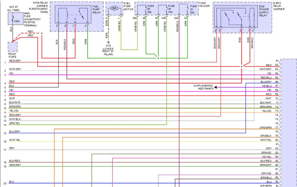

8 years 11 months ago - 8 years 11 months ago #14957 by Chad

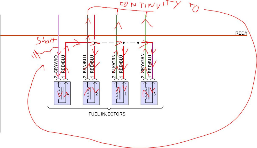

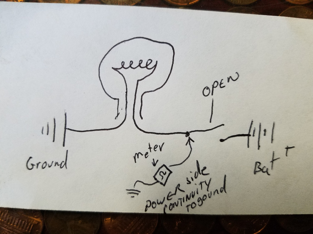

Keep in mind that continuity to ground doesn't, necessarily, mean shorted to ground. In this picture, I attempted to draw a light bulb with an open on the power side. The principle is the same for your injectors. You can read continuity to ground THROUGH an UN-energized component.
Last edit: 8 years 11 months ago by Chad.

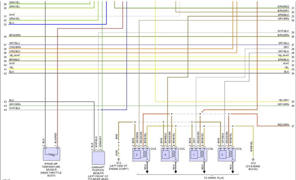

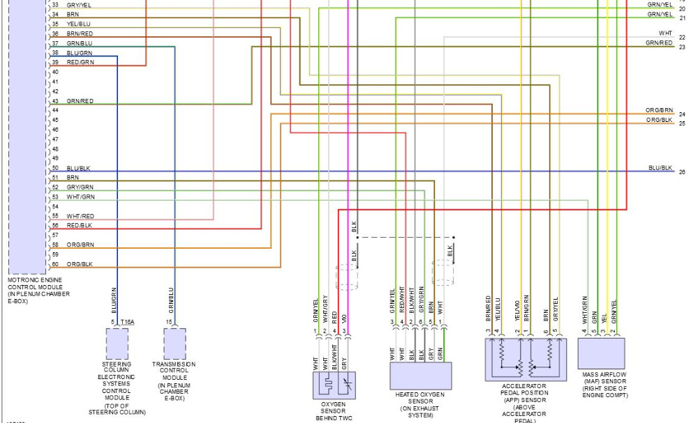

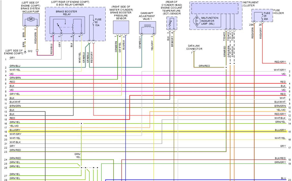

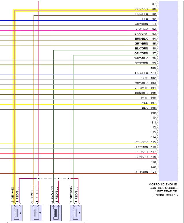

8 years 11 months ago - 8 years 11 months ago #14958 by Chad

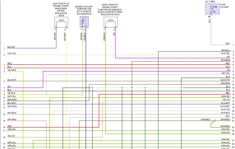

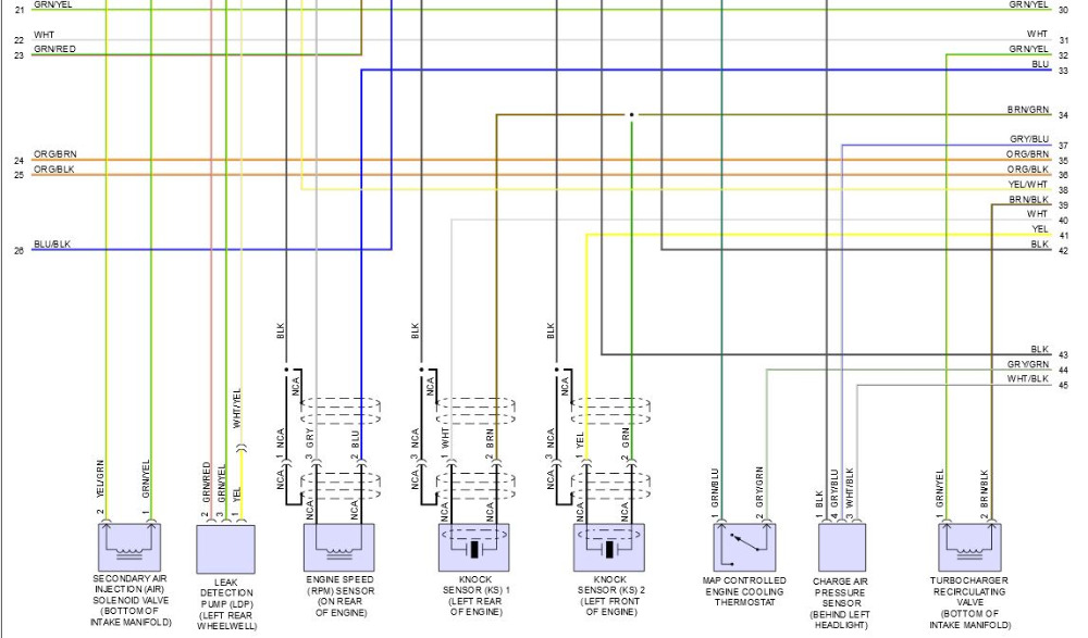

Schematics pages 1 and 2

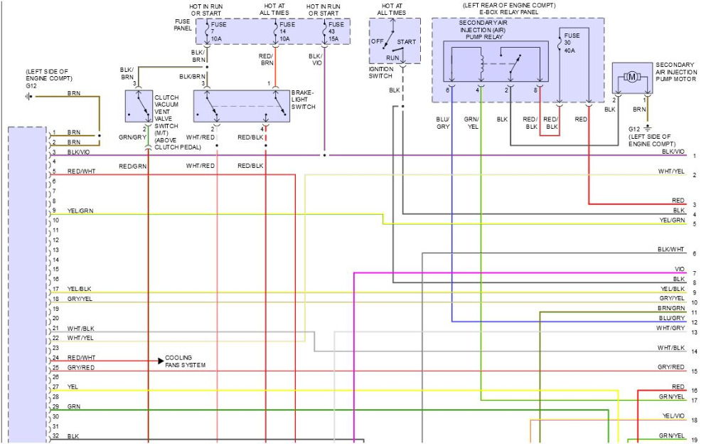

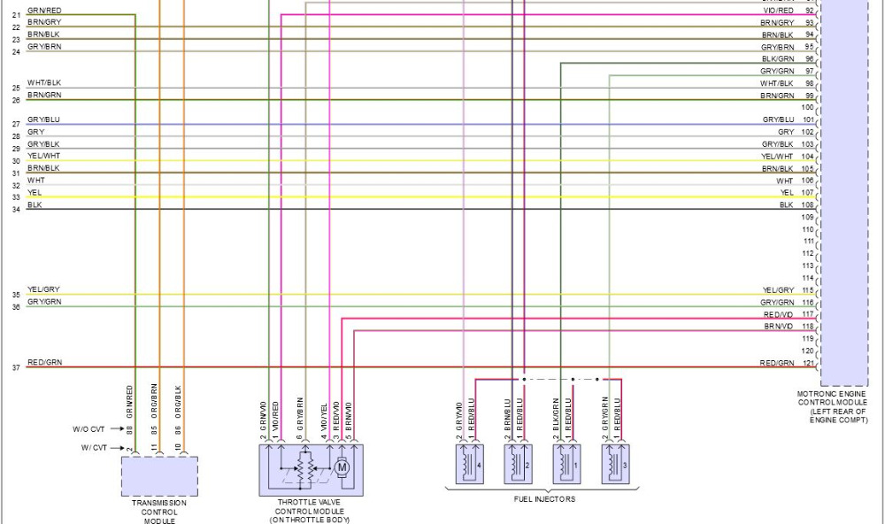

8 years 11 months ago #14959 by Chad
Schematics Pages 3 and 4

pole71 wrote: Keep in mind that continuity to ground doesn't, necessarily, mean shorted to ground. In this picture, I attempted to draw a light bulb with an open on the power side. The principle is the same for your injectors. You can read continuity to ground THROUGH an UN-energized component.
This is exactly right. I bet this concept is what confuses people the most when using a power probe. "Why is there ground on the power side of the bulb?" "Is it a short to ground on the power side?" "Why isn't it blowing the fuse?"

8 years 11 months ago #14973 by EricGoodrich
Replied by EricGoodrich on topic cylinder #4 fuel injector has constant ground signal
Continuity to ground on the red/blue wires while the connector is unplugged is through fuse 32 then fuse 28 and through the fuel pump motor. That connection is broken when removing either of those fuses. I suggest ignoring continuity to ground on those wires when unplugged because that is normal. You should only focus on a short to ground on the grey/Violet wire for fuel injector #4.
