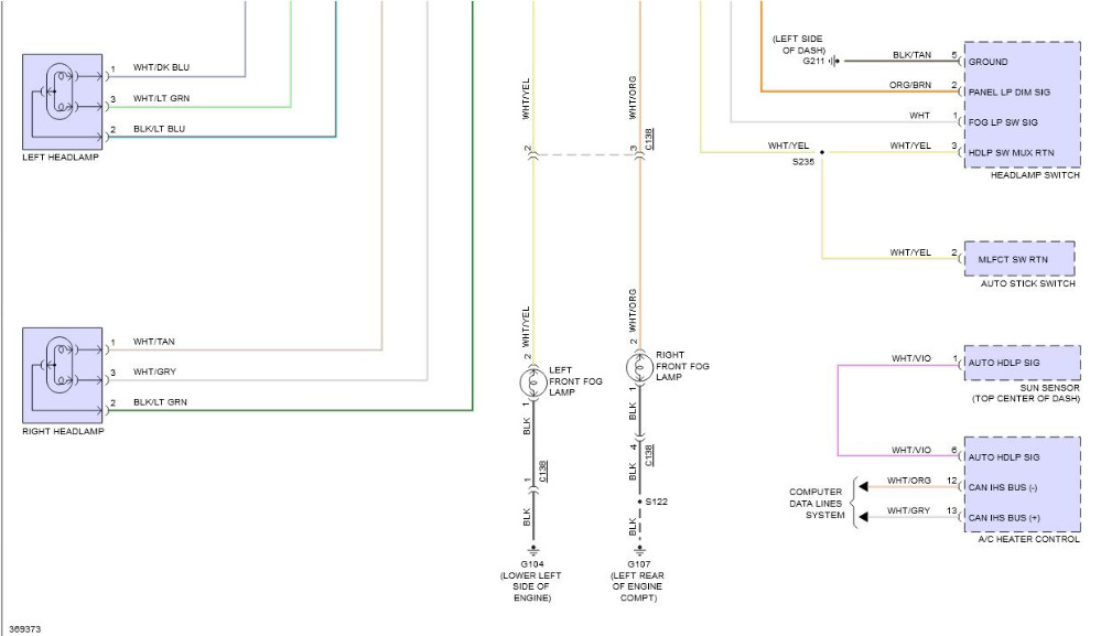

2011 dodge ram 2500 6.7l.
I have no left headlight low/high beam. Right side is fine. Wondering if anyone has a complete wiring diagram, or suggestions?

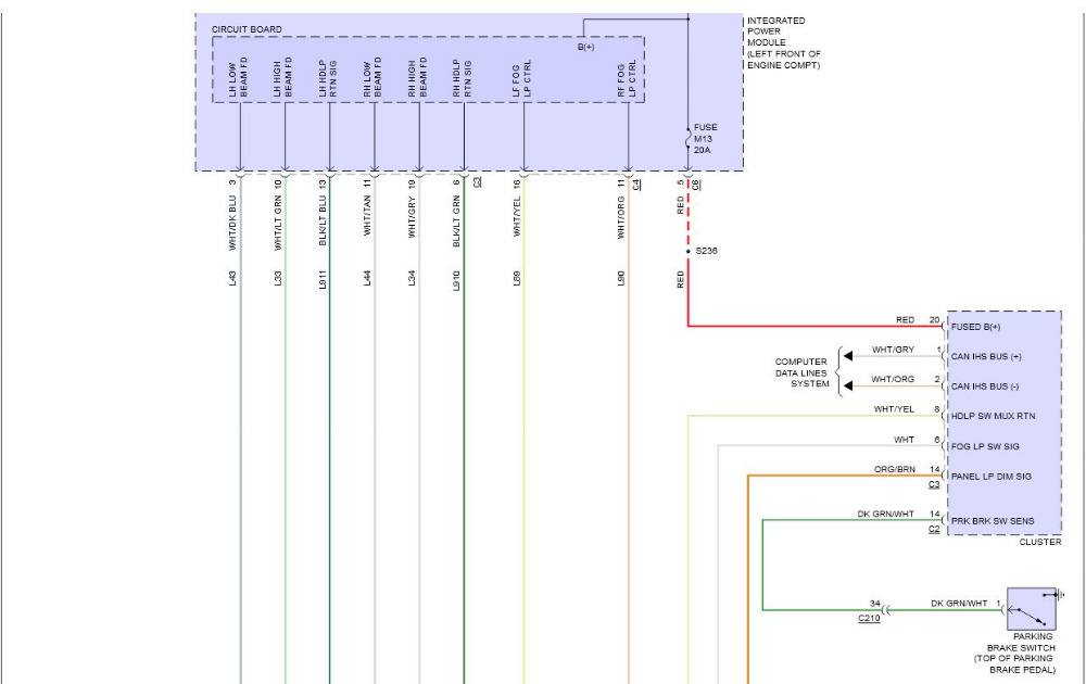

Hey HD/MW Canada! I think your title for this thread got confused with your other thread? I edited it for clarity, hope you don't mind.
If both the low and high are inop, then it's possible there's a ground issue between the headlight and the TIPM. I'd suggest taking three voltage readings at the headlight with the headlights on. White/dark blue should show 12V with the lows on, and the white/light green should show 12V with the highs on. The black/light blue is the ground for both, and should never have more than .5V at any time.
If you see high voltage on the black/light blue, you're either looking at high resistance in that wire, or a bad TIPM.
