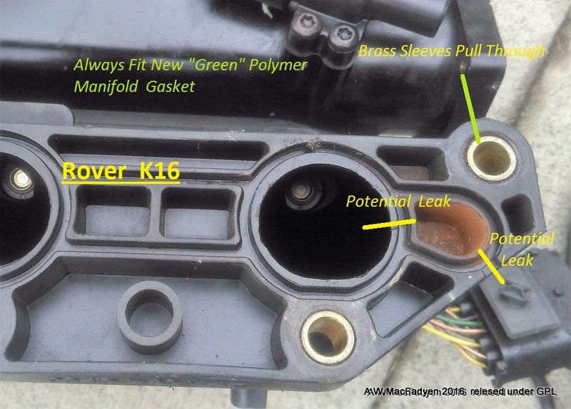

A couple of shots of fairly typical inlet K16 leaks --- very hard to spot
Last edit: 10 years 1 month ago by Andy.MacFadyen.

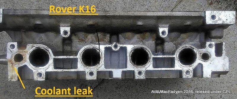

10 years 1 month ago - 10 years 1 month ago #1761 by Andy.MacFadyen
Replied by Andy.MacFadyen on topic Heater core?
Note rust trace on cylinder head.
10 years 1 month ago - 10 years 1 month ago #1764 by Andy.MacFadyen
Starngely the liners are meant to be a fairy loose fit, a lot of the problems came in the early 1990's with a revision in the way the block was cast and a whole load of relatively minor installation issues.
On these post 1995 engines liners should sit just proud of the block.
There are shims available to fit under the liner and fitting them is simple ! a matter of disconnecting the big end bearing and gripping the liner by hand and pulling it out complete with piston.
The shim or shim is then fitted over the bottom of liner which is coated with a generous coating of non-hardening jointing paste and slipped back into place.
