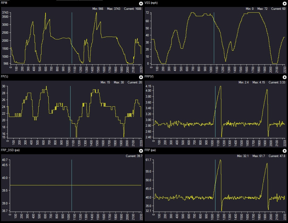

- Fuel Rail Pressure Sensor PSI at idle: 37-39PSI
- Fuel Rail Pressure Sensor PSI at WOT: 37-39 PSI
- At some point, usually just as I let off the throttle at the end of my WOT run the FRPS will spike to 49 PSI
- Bank 1/2 Upstream O2 Sensors will NOT read rich during WOT until the FRPS reads 49 PSI. At that point O2s will be pegged rich. The initial instantaneous romp on the throttle, both Upstream and Downstream O2s will read full lean for a second till the truck starts accelerating.
The fuel pressure staying at 37-39 PSI, and spiking after a WOT run, is normal in my experience. The O2's also sound reasonable, as not every system will switch to open loop right away upon WOT application. How severe is this hesitation? :huh:

The PCM's command to the FPDM is weird... it's a 'halved' signal. :blink: When you saw 86%, you were actually looking at a 14% duty cycle, which equates to a 28% duty cycle of the fuel pump by the FPDM. Make sense? :lol: Your lowest reading of 67% was actually 43%, which equates to 86%, which is about as close to full fielding of the pump as the FPDM will get. I've never seen the command signal go over 50%.
www.scanshare.io/share/rOyxN7DxDU201WIeEqbelQ
I am wondering what ACTUAL fuel pressure should be under load and at idle. Depending on if I can put time into this issue, I'd like to T my fuel gauge into the system some place to get mechanical readings. I am not ruling out a bad FRPS.
Your gauge will almost always show you HIGHER than the FRPS, because of the vacuum hose. If you disconnect the vacuum hose, then the gauge should match the gauge exactly. Why have the vacuum hose? Who knows. :silly:
That all makes complete sense. That links has a bunch of info too. Thanks for sharing.
Shouldn't the vacuum in the FRPS cause a high than normal pressure reading on the scanner? I figure the vacuum will pull the diaphragm up, same direction the fuel pressure would push it. The fuel pressure instantaneous spike at the end of my WOT run would make sense if the vacuum would create higher than normal readings. At the end of the WOT run when I snap the throttle shut, vacuum would spike and create that spike in the FRPS reading which then bleeds off as RPMs decrease and vacuum decreases. Reason I say this is the spike in pressure was not gradual, it was a straight line up even zoomed in on the scanner. I can't imagine the Fuel pump being able to raise the pressure 10psi so instantaneous by the module ramping voltage. Your thoughts?
I also read that the reason they measure fuel pressure referenced to manifold vacuum was to get the fuel pressure that is at the injectors....I am having a hard time wrapping my head around that.

8 years 11 months ago #15154 by Tyler
Replied by Tyler on topic 2007 F150 5.4 Possible Low Fuel Pressure
Ah yeah, I think you're right about the vacuum hose and fuel pressure. I got confused! :blush: I just know that pulling the vacuum hose makes it match the physical gauge.
I hadn't considered that the vacuum hose might be responsible for the pressure spikes after WOT. :blink: I always figured it was because the PCM cut injector pulse when I lifted off the throttle, and the fuel pump is suddenly deadheading against a rail that isn't flowing any fuel.

I guess the only way to confirm that is to hook up a fuel pressure gauge. I suppose you could scope average voltage to the pump to watch the fluctuation, throttle input, FRPS Signal and a fuel injector to see what is happening too. Next time I have a ford I'll scope this out just because it might be easier than T'ing in a mechanic fuel pressure gauge or pressure transducer. Unless I run into an older ford with a schrader valve.
What is interesting is your FRP(V) waveform (well mine was on the scanner not the scope) is opposite of what mine looked like. On this truck the beginning of the spike was straight up and gradually decreased, yours looks like it gradually increased and decreased suddenly.
