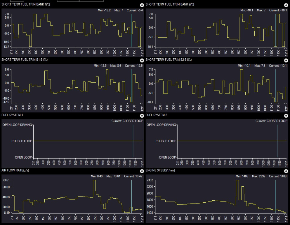

Hi guys,
So I monitored data from cold to op temp and nothing significant, but under increased RPM, found something interesting.
LTFT is fairly consistent over bank 1 &2, but at 3250 RPM (my foot got a bit carried away, started at 2500), I see STFT11 is lower than the others. I known LTFT is the one to be most concerned with, but could this provide a clue? LTFT is still showing lean throughout the rev range. (Images attached)
8 years 11 months ago #15220 by Tyler
Feel free to disregard those ST FTRM11% and ST FTRM21% PIDs. ;-) They're not true fuel trim readings, just misleading PIDs from when OBDII was first developed. The ST FTRM1% and ST FTRM2% are the ones to watch.
Long term trims of -4.7% and -3.1% is pretty excellent overall, so I wouldn't read too deep into that. I agree with Eric - without driving it, you may not be able to reproduce the conditions under which the P0171 set. :unsure:
The following user(s) said Thank You: lc1927

8 years 11 months ago #15266 by Tyler
lc1927 wrote: I’m safe to ignore that figure, even when 2 & 21 match up? I wasn’t aware that those numbers were redundant, so appreciate you letting me know that.
Yeah, those PIDs are weird. :silly: Most of the time, they're pretty reasonable, and close to what the actual fuel trims are reading. I suggest ignoring them because at certain times, especially during load changes, they can be a bit misleading. Here's an example:
Short term on bank 1 is showing -5.4%, while short term B1S1% is showing -12.5%. :blink: 5% is no big deal, but 12% could be cause for concern.
I did clear the P0171 several times and it was only thrown at idle and from moving the car within the yard at home- unfortunately without freeze frame I can’t determine supporting figures from when it appeared. The fuel trim numbers I have seen throughout don’t support the fact it is thrown- confusing!
I'm not certain about Renault, but I have run into Volkswagens with lean codes that show fantastic fuel trims in OBDII. :unsure: I go into the learned block values on the OEM side, and bam, the trims are all screwed up. Point is, it's possible that OBDII isn't telling you the truth about the trims.
Found a crack in PCV hose.
Vehicle uses corrugated plastic hoses and these have gone hard and brittle over time. When I removed the PCV valve, the cracked hose split in 2.
Hopefully once the this is replaced my idle issue will be resolved, lean condition resolved and hopefully spongy brake pedal resolved- which I thought was narrowed down to the master cylinder, but most likely the air leak that would have upset the booster vacuum.
Nice! :cheer: For science, let us know what your scanner says about the trims after the fix?
