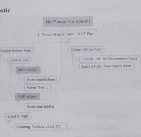

I'd suggest watching the upstream O2 and Engine Load while at wide open throttle through first and second gears. The O2 should go over 800mV while at WOT, and the Engine Load should go to 85% or higher. If the O2 doesn't go rich at WOT, then the engine is running out of fuel. If it does, then look at the Load. If it's low, that'd suggest a breathing issue.
There's tons of SD videos out there for low power complaints. This one might be a good place to start:
For reference, this is the flow chart I follow for low power complaints:

Dear Tyler,
Thanks for your quick response. what I mean is " the O2 sensors become rich and lean at wot" if you watch the video closely and aim the o2 sensors, you will see o2 sensors fluctuate between 50-800mv. How come at WOT the engine o2 becomes lean with good fuel trim?

"How come at WOT the engine o2 becomes lean with good fuel trim?"
WOT should be open loop so doesn't depend on fuel trim.
