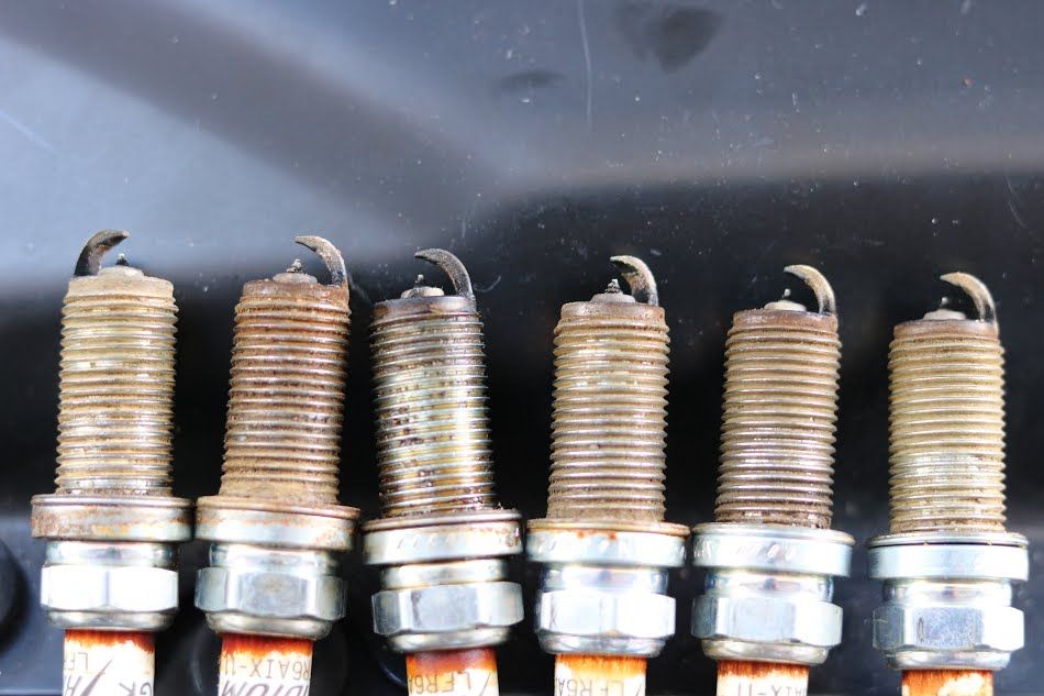

i have the scanner but i don't know if a have that option .. i'll check later that .. also no engine knock,or ticking noise .. the car runs fine after few second from a cold start, the fuel economy is unknown but it has lots of power (i'm a Honda driver)
the main reason that we're addressing this issue is due the smog inspection.
i just took the spark plus out and looks bad the gap is over 0.65 inches
Last edit: 8 years 11 months ago by jaivs26. Reason: to attach a picture

With those spark plug gaps you are lucky the coil packs secondaries didn't get the insulation tracked by excessive kilo volts on the secondary but the symptoms aren't a good fit for an ignition issue. I would go with Naros's suggestion.

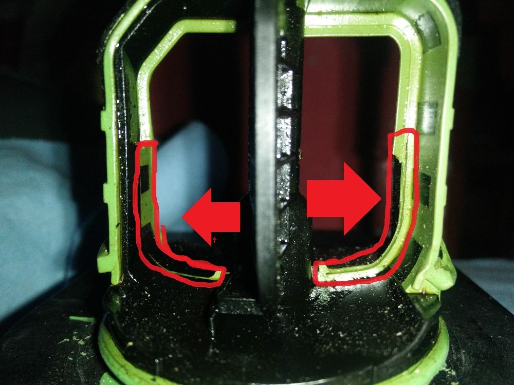

i remove the intake to inspect the DISA under the intake and i found out that is missing 2 pieces of gasket.. the flaps on both valves does not have any movement but i can't test the valves when are removed from the intake..
do you guys know other way to test those valves outside of intake?

  • jaivs26
  • jaivs26's Avatar Topic Author
8 years 10 months ago #15640 by jaivs26
Replied by jaivs26 on topic 2007 bmw 530i regulating lambda probe help
So i did change the Disa #2 under the intake but i'm still getting 2C28 and 2c2c code but what i did was scanned the car as GLOBAL OBD and is giving me a p0174 ..
when i first start the car the signal in the scanner and is maxed out to 5 volts and then goes to 2.8 Volts and same thing when i looked a the short fuel trims when i started the car it goes 29% and then 34% and after sew seconds it goes to 0%
my guess is that the O2 sensor is defective because i never got that code before i was just getting the P0050..
  • jaivs26
8 years 10 months ago #15667 by jaivs26
Let me tell you guys this car is driving crazy!
i was trying to figured out why the bank 2 is maxed out at start up on the scanner the o2 sensor reads 5.0 volts and short fuel trim reads 29 %
after 30 seconds or more the computer goes to a default strategy and ignores the bank 2 o2...
i remove the DISA number 1 the one is on top of the intake above the throttle body and started the car and the valve jut moved 10% but not all the way, so i went to youtube and found some videos and one guy opened with a razor blade so i did that and found out that it was full of oil,
so i need to replaced and i think i need to order oil separator..
