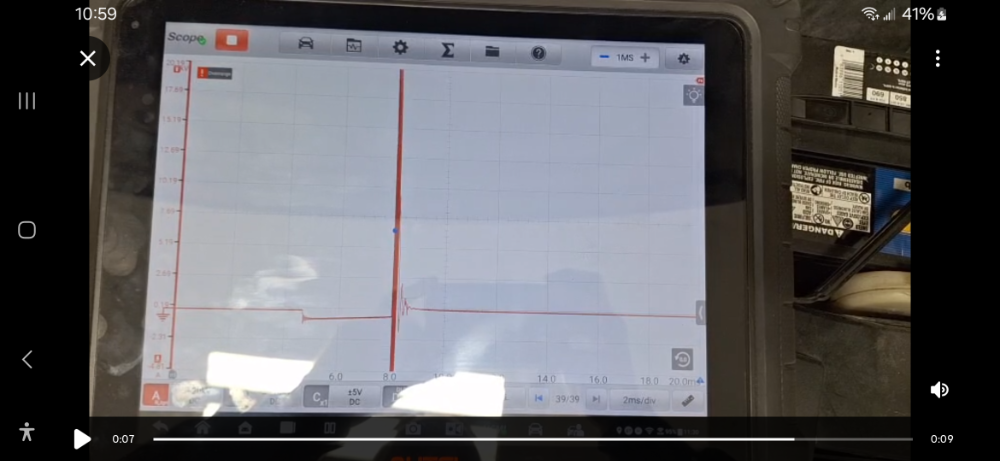

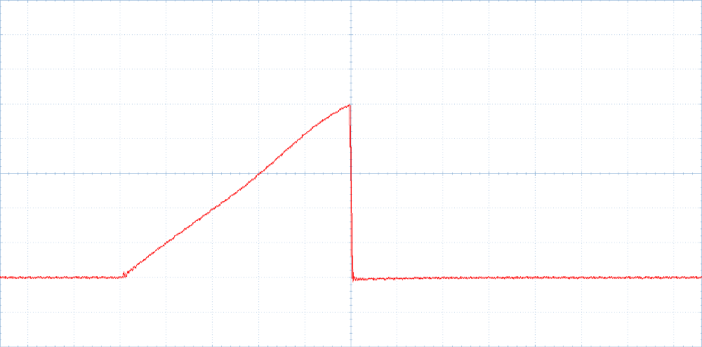

I would like some assistance in understanding what is taking place in the attached ignition waveforms taken at idle from coil number 4, bank 2, on a 2006 Honda Fit with a L13A (1.3L i-DSI) engine coil on plug (COP). The car misfires between 3,000 and 4,500 RPM while driving. This was the only COP with an abnormal-looking waveform.
Can someone explain what can cause the 'noise' at the end of the current waveform?

1 year 10 months ago #72979 by bills4065
Are these waveforms at idle? If so, try posting the waveforms at a rapid snap throttle- see how they look then.

1 year 10 months ago #72980 by kingdombusinessseedonearth.abdullah
Replied by kingdombusinessseedonearth.abdullah on topic Assistance need with ignition waveform for 2006 Honda Fit with L13A i-DSI engine
Yes, they were taken at idle. I will try to take the quick snap throttle tomorrow, God's willing.

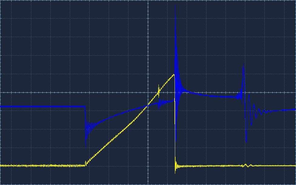

1 year 10 months ago #74538 by kingdombusinessseedonearth.abdullah
Please see the attached snap throttle images.

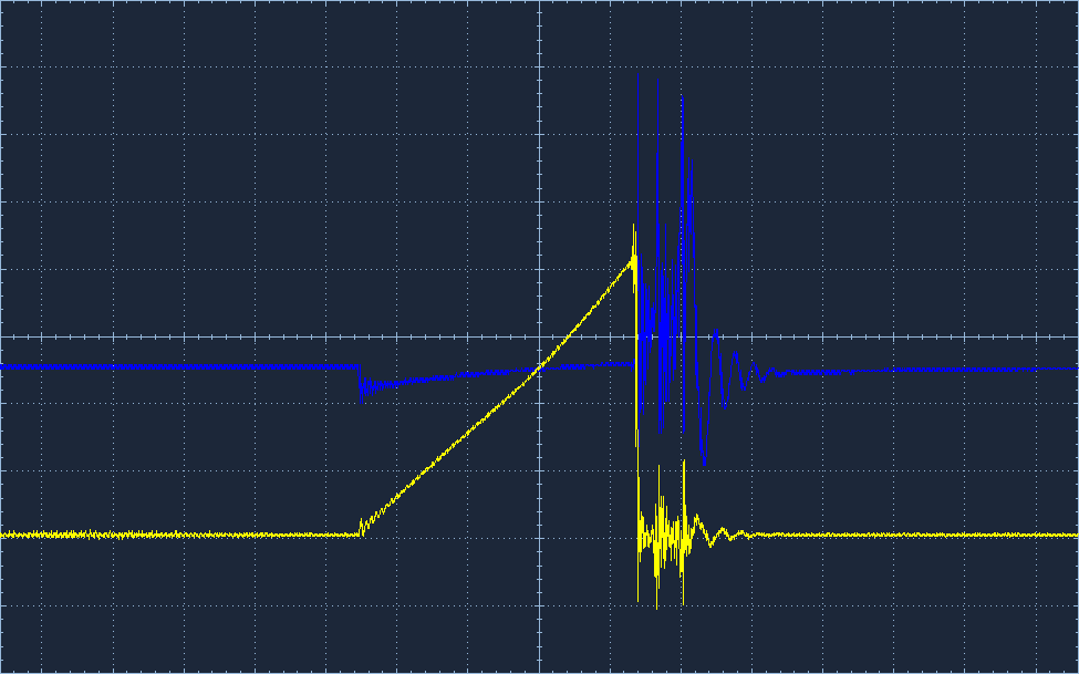

1 year 10 months ago #74540 by kingdombusinessseedonearth.abdullah
Hi, good night.
I added the snap throttle waveforms to the forum. Would you be able to help me analyse them, please?
1 year 10 months ago #74644 by Chad

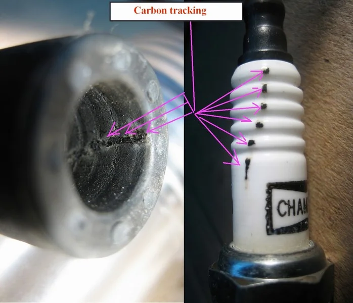

Sometimes, the spark can track down between the outside of the spark plug and the spark plug boot,  arcing to the Nut/threads of the spark plug, outside the cylinder. Especially, during acceleration or snap-throttle. I would pull the coil and look inside the boot for "Carbon Tracking". Also, look at the spark plug porcelain for tracking.

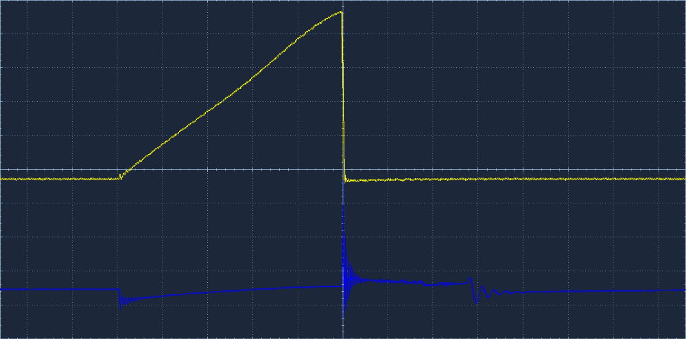

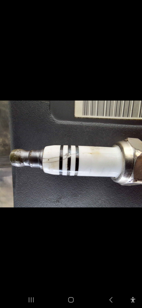

1 year 10 months ago #74812 by Noah
Looks a bit like Tyler's cracked spark plug waveform from this week:
These images belong to Tyler, not me!
Hope he doesn't mind
1 year 10 months ago - 1 year 10 months ago #74833 by bills4065
Please keep us posted on findings. I am also thinking carbon tracking on cracked spark plug.
I did not see a good spark line at the snap throttle personally.

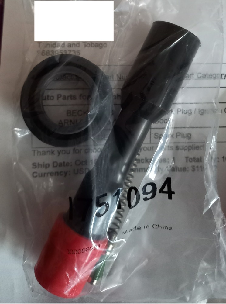

Initially, when the misfiring began, I did a cylinder drop test using my test light, and spark was leaking along the coil boot (see image).
I changed the coil boots and the spark plugs, and the misfiring (bucking) stopped for a few weeks. Unfortunately, the misfiring (bucking) returned after about three weeks. I captured the waveforms, and I did another cylinder drop test, and spark was still leaking from the boots. Someone said that if the spark is strong, it is possible or normal to leak through the boot. Can anyone confirm if that statement is accurate?
Spark Leaking from boot
Attachment not found
Images of the new boot
Images of the old boot with corrosion

1 year 10 months ago - 1 year 10 months ago #75516 by bills4065
Did you use oem parts for replacement? Ignition parts I would only buy from the dealer. And even then it is possible to still get a bad part. That bag says that part was made in China. Keep us posted.

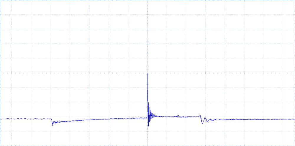

1 year 5 months ago - 1 year 5 months ago #90224 by kingdombusinessseedonearth.abdullah
Replied by kingdombusinessseedonearth.abdullah on topic 2006 Honda Fit - L13A i-DSI engine misfire around 3K - 4.5K RPM when driving
Good afternoon.
I'm providing an update. After changing the coil packs (COP) and the spark plugs, the waveform is much better at idle and during snap throttle. However, the misfires are still present at 3000 to 4500 RPM only while driving (not at WOT when accelerating).
I'm going to capture the crank signal waveform to see if there are any anomalies. I'll provide an update later on.
Last edit: 1 year 5 months ago by kingdombusinessseedonearth.abdullah. Reason: adding images of the waveform for the new coil pack and plugs
