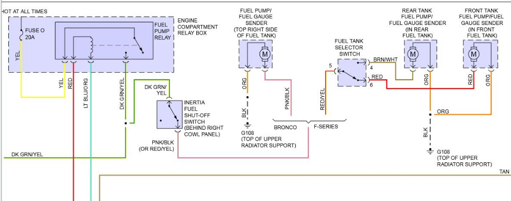

I've been able to get spark and spraying some throttle body cleaner got the truck to run for a few seconds. I have zero fuel at the rail and cannot get the pumps to prime now. Fuel pump relay seems to click and I've begun testing the circuit at the pumps, inertia switch, and fuel tank selector. I believe I should have 12V all around with the key on right?

I don't have the diagram for you at the moment but you maybe someone can post it for me (I'm o a cell phone) well need to take a look at the fuel selector valve pigtail and possibly the selector switch

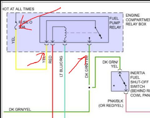

8 years 10 months ago #15608 by Chad
Replied by Chad on topic Re:1994 F150 no fuel!
Here you go.

Thank you pole71. I need help understanding my results. Everywhere I probe I get an initial 12v jump with turn of key (brothers helping) then immediately the circuit will drop back down to lower readings (9.8V-2.6V i.e.). Is the initial 12 V supposed to hold. I've followed this from the pumps--selector switch--inertia switch--to power distribution box. I am still getting the initial 12V jump during key on/brother cranking but very quickly losing it to read 9.8V. Honestly that is the DKGRN/YLLW wire to pin 8 that says FPM.

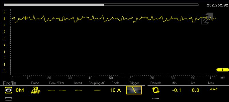

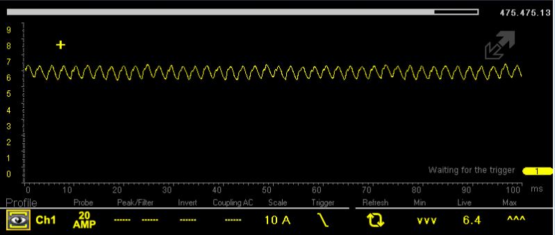

8 years 10 months ago - 8 years 10 months ago #15613 by Chad
This waveform is of a blower motor, not a fuel pump, but a motor is a motor. Anytime I get an intermittent blower/fuel pump problem, the first thing I do is look at a current waveform. This first wave is of the NEW blower motor. This is how a motor, be it a pump or a blower, should look.
This is a wave of the bad motor. When the wave looks like this, I replace the blower/pump, whether it is working at that moment, or not. When, not if, the motor stops in a bad spot, it cant get started. Banging on the tank jostles the pump, just enough, to get out of the "dead" spot.
Having Dual tanks decreases the probability of this being the problem.
You may, or may not, have access to a scope. I just thought I would throw this out there.

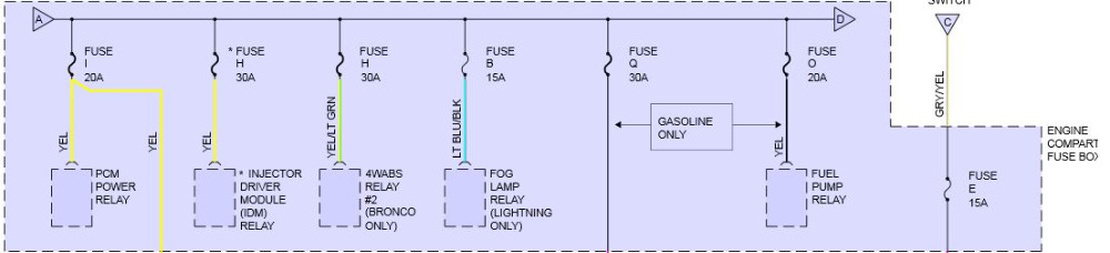

:blink: I can't explain that, at this point. But, if your dropping voltage at the fuel pump, I don't think THAT problem is with the PCM. Power for the fuel pump comes from 20 amp FUSE O, which is in the engine compartment relay box. What voltage do you read at THAT point when energizing the fuel pump? If you get a strong, solid battery voltage, move down the line and check the wire going INTO the inertia switch (DK GRN/YEL), then the wire going OUT OF the inertia switch(PNK/BLK). Keep moving down the circuit, working your way towards the fuel pumps.

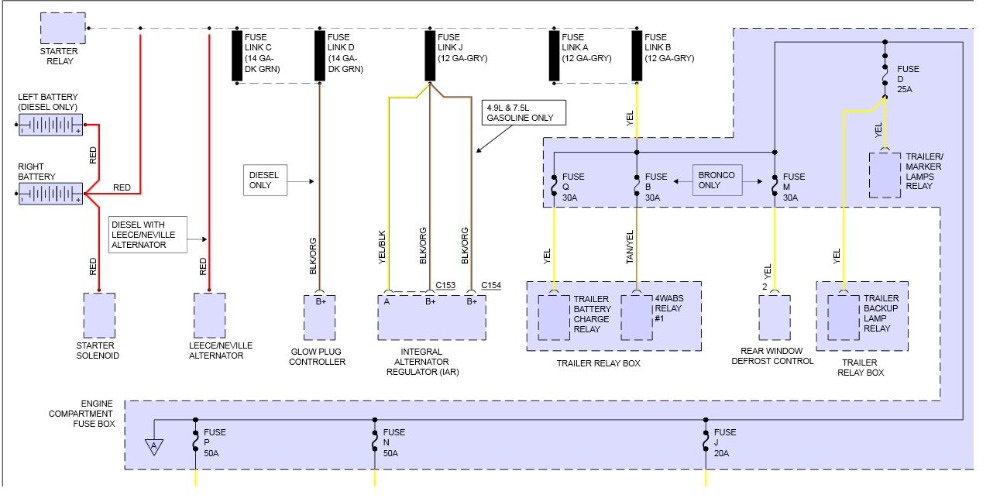

If FUSE O is showing a voltage drop, then you need to work your way back closer to the battery..(my next stop would be before and after the fusible links)...All the way back to the Battery cable connection, if necessary. SOMEWHERE is a dividing point between voltage drop and no voltage drop.

Okay fuse O is dropping on engine crank. 12ish to about 10-11. Normal or is that typically going to happen. Which path am I following back to the battery? I don't see on the most recent diagram you sent.

It is normal for system voltage to drop a little while Cranking. I would say you do not have a voltage drop at Fuse O. What about WITHOUT cranking? Key on, fuel pump priming stage. Compare voltage at these points....(Fuse O, and terminals 87 and 30 of the relay)
