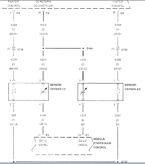

8 years 10 months ago #15688 by Tyler
That's disappointing to hear. :-( I really hate to ask, but where did you get the replacement converter from? Because it seems to me like the catalyst just isn't storing oxygen at all, and is instead just dumping it right back into the exhaust.
If you want to prove out a connection issue, there are a couple options. One would be to use the 5V bias on the signal wire like Cheryl mentioned. The scanner won't show it due to OBDII standards, but those sensors start out at 5V cold, and get pulled down to 0-1V with heater operation. You can measure for this with DMM, and further check the O2 signal ground by shorting the signal TO the ground. If you see the bias go to zero, then you know the ground is OK.
The other would be to disconnect the PCM and load the O2 wires with some kind of light bulb, or even an incandescent test light. It's work, but it'll eliminate all doubt about the wiring. ;-) We can provide you with wiring diagrams and pin numbers if needed.

Also, this is the wiring diagram for both downstream O2 sensors:

8 years 10 months ago #15694 by jb13
Thanks for the advice and the diagrams!
I'm going to look into the wiring tomorrow and see if it helps my problem.
