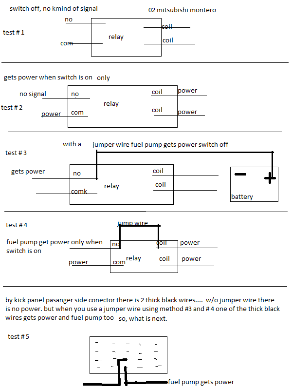

hi me felipe tapia. first thank you for you time. i got your e-mail. thank you so much.. well here i sent you this information. i did my self. hope you understand.. question. this 02 Mitsubishi montero has a fuel cut off switch, or inertia switch? if so. where is locate it. well you are the master. if you so kind pls let me know what to do. thank you so much. aah and I replace the relay and still not running power between pin and the wire.
