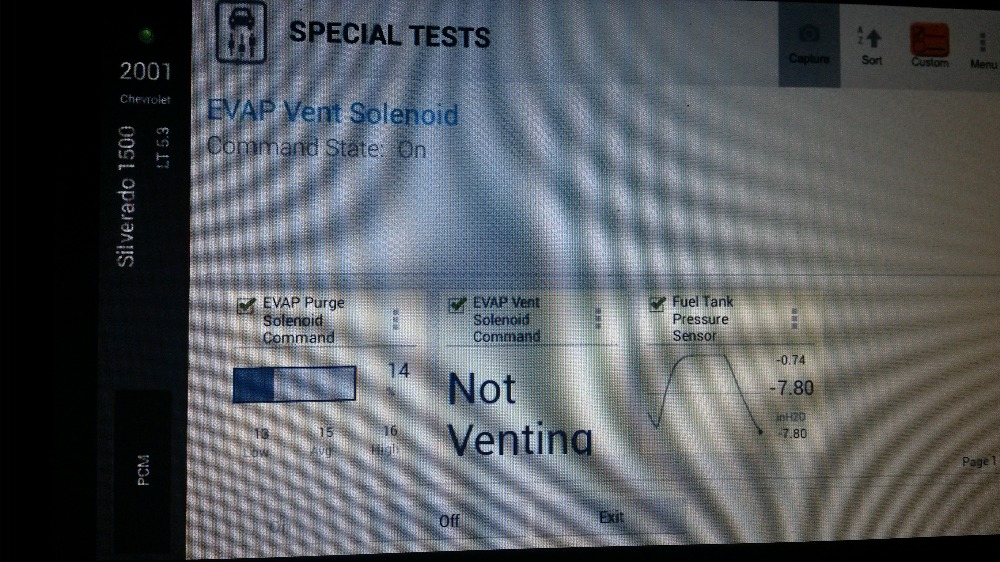

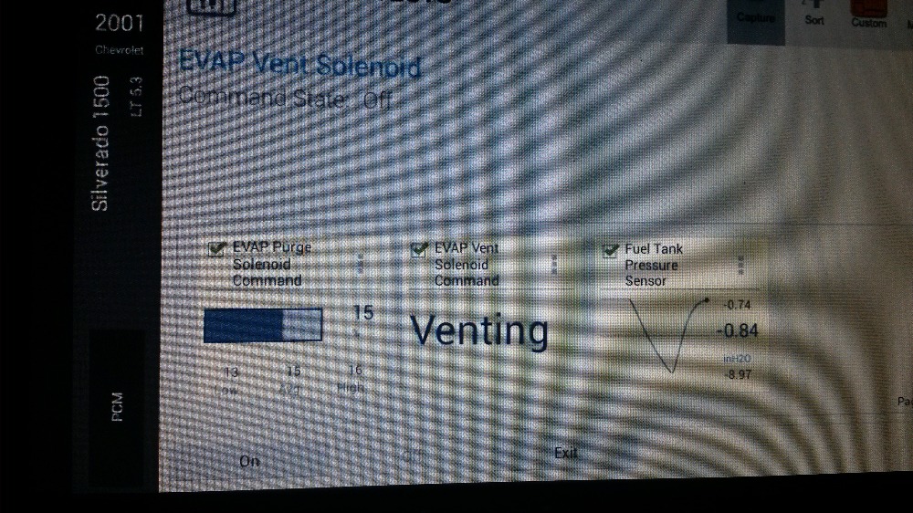

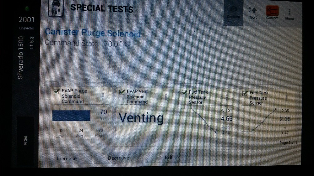

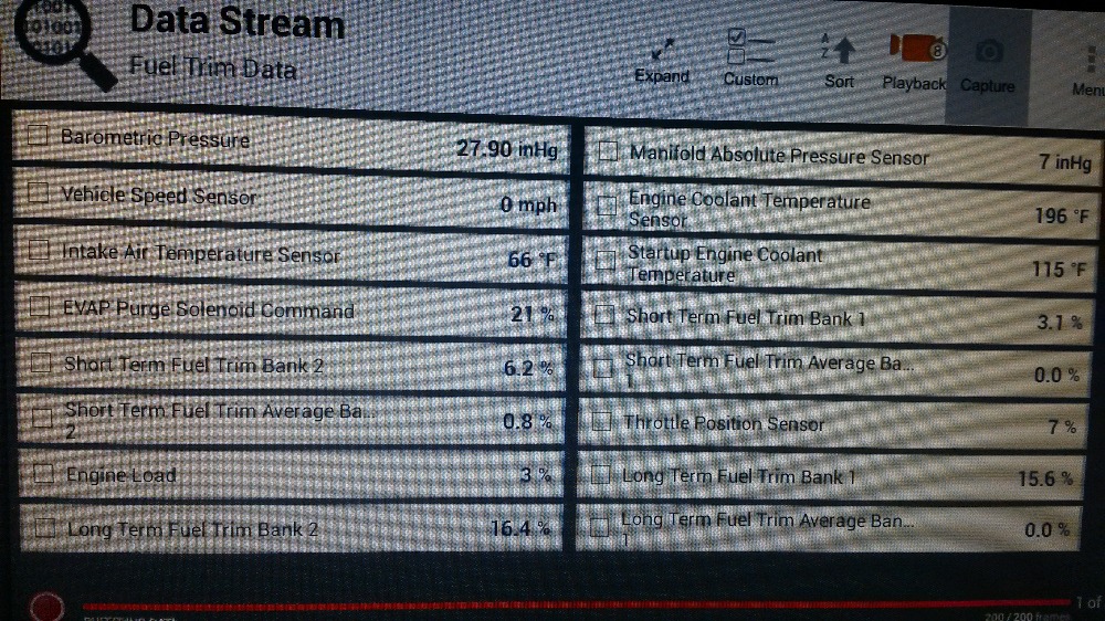

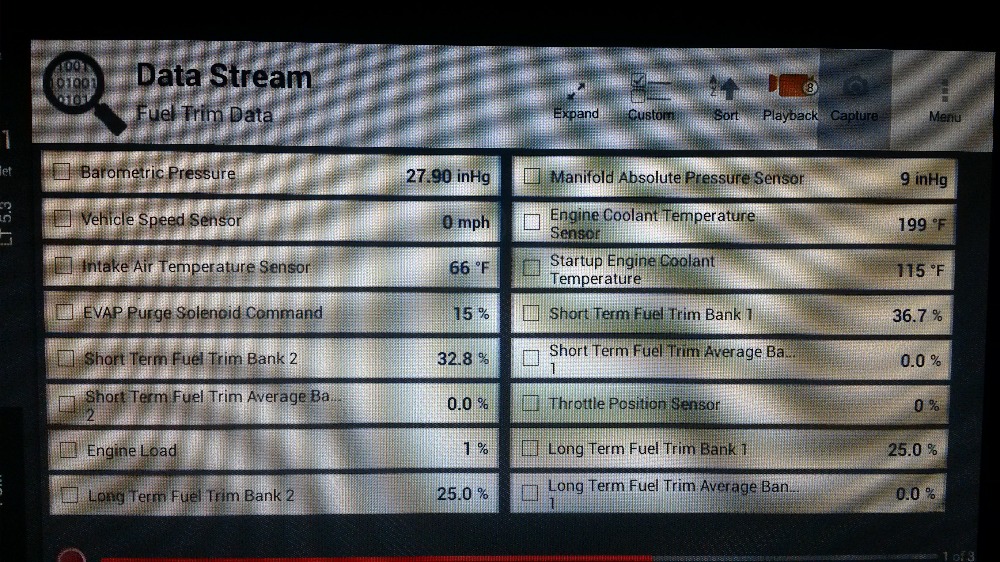

Hooked up the scanner and evap reading was at 0%....disconnected power and tapped on valve and then it started reading. At idle the purge solenoid said 15% and stft's were 36.7% and 32.8%. At 1000 rpm the purge solenoid says 21% and stft's read 3.1% and 6.2% also the Purge solenoid when commanded in the off position at 15% the fuel tank pressur sensor is at -0.84 and when commanded on at 14% the fuel tank pressure sensor is -7.80. I apologize if I'm posting the wrong info but I'm not a mechanic. Just a do it yourselfer tired of being a parts changer.

+57.8% Fuel Trim Bank 1(Drivers Side, Cylinders 1,3,5,7)
+61.7% Fuel Trim Bank 2 (Passengers Side, Cylinders 2,4,6,8 )
VERY HIGH Fuel Trims.
What looks like to me is when you activate the purge valve, reason your fuel trims go down is probably due to the fuel vapors you are drawing into the intake manifold which will help rich the mixture. I've seen this go both ways, lean or rich but in your situation, looks like it is adding vapors and lowering the additional fuel command. Your long term fuel trims are still high. long term fuel trims are your computers fuel trim memory. If you have a long term fuel trim (LTFT) of 16% and a Short term fuel trim STFT of 6%, then you have a total of +22% fuel trim. If short term stays at 6% long enough, then the long term will eventually add an additional 6% to its value bringing the short term value to 0 and long term fuel trim to 22%
If you raise the RPMs, do the fuel trims get better or worse? Don't manually activate purge valve. If they get better, than its a vacuum leak, if it gets worse or stays the same (trims might be maxed out), than possibly a fuel delivery problem.
