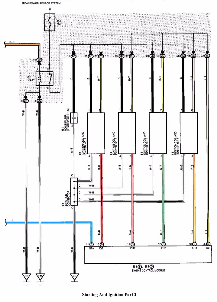

No signal coming from ECU to trigger the coil on those same cylinders 2-4 on 1 and 3 I did get a trigger signal and are fireing. Checked wire for open circuit and tested OK and also for a grounded circuit.
Looks like ECU but mechanic said that the ECU tested OK. Said wiring problem coming from crankshaft sensor to ECU. Tested wire for ground and it was OK tested wire for continuity and it was good.
Suspect ECU. Does anyone know if this ECU needs to be programmed when and if I Replace it?

8 years 10 months ago #15779 by arbez
Replied by arbez on topic 2001 Toyota celica
Your really not giving us much information here, but I'll give it a go.
Looks like 4 wire coils.
These 3 are the same for all coils
Black - Battery positive from ignition relay
Black/Yellow - Power from ECM
White/Black - Ground
Coil Control by ECM
Cyl 1 - Red/Black
Cyl 2 - Red/White
Cyl 3 - Green/Red
Cyl 4 - Red/Yellow
Check inputs at all coils & tell us what you are missing. If you are missing coil control, check outputs at ECM
Coil control at ECM
Cyl 1 - Red/Black - Pin 10 @ ECM
Cyl 2 - Red/White - Pin 11 @ ECM
Cyl 3 - Green/Red - Pin 12 @ ECM
Cyl 4 - Red/Yellow - Pin 13 @ ECM
Once all the above have been checked, let us know the results & we will go from there
Good Luck - arbez

Wires tested good for Power from ignition and Power from ECU, Ground was good as well. no coil control on cylinders 2 and 4

I still need to verify powers and grounds on ECM (but I have power and ground to all coils, would that indicate power and ground being OK on ECM? Will check anyway). Do you have a schematic that shows what pins on the ECM to check?

Don't have a scope but will visually check the wheels for damage or cracks. Did not check for powers and grounds on ECM as I figured it was OK since I'm getting power and ground at each coil. Will check but I need a schematic that can show me what pins to check.
8 years 10 months ago #15787 by arbez
Do you have power at the cam & crank sensors? Might be 5V. They share power from the computer. Signal out is orange wire from crank sensor & blue from cam.
At the computer - Looks like connector "C"
Pin 24 - White - Shared power
Pin 16 - Orange - Crank output
Pin 15 - Blue - Cam Output
Signal should be checked at the orange & blue wires with a scope.
Wiring diagram for the ECU is 6 pages. I'll see if I can find an online source to link you to.
8 years 10 months ago #15788 by arbez
ECU wiring diagram - Thanks BBB Industries
