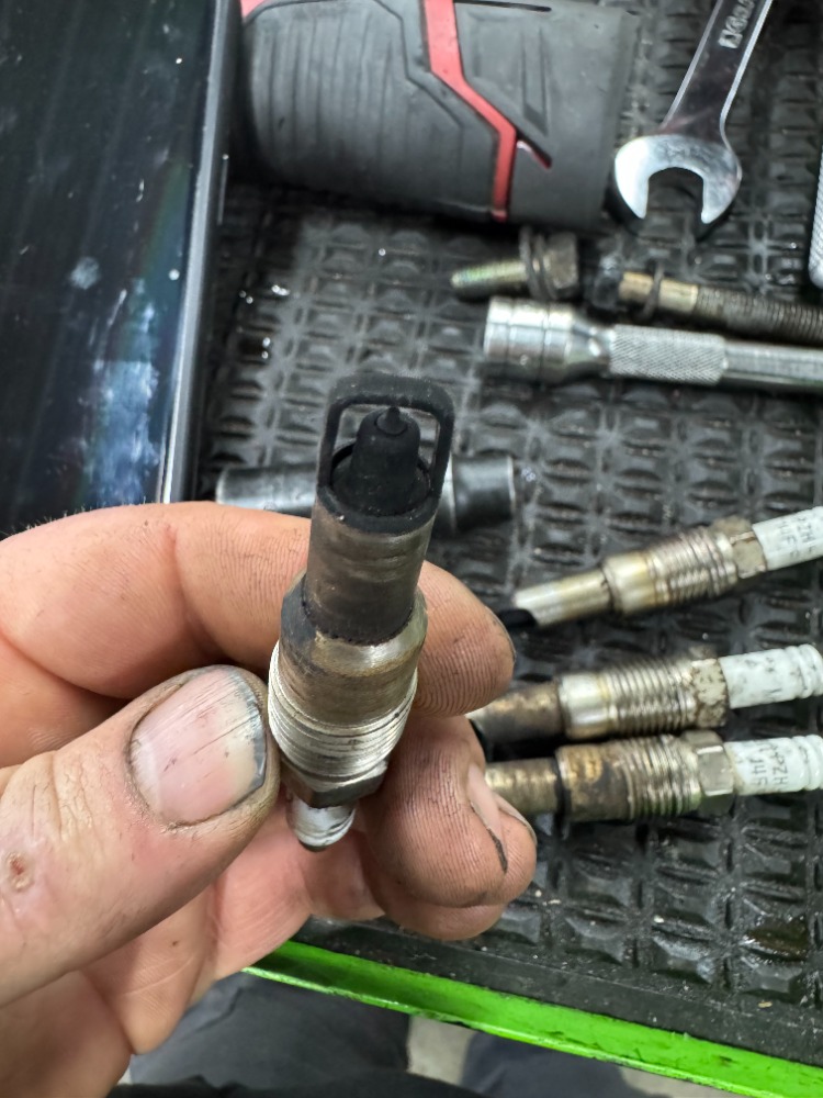

We also had voltage issues at the injectors and PCM coming from the FPRelay, fuse block, but now it is back and we are moving forward. We disconnected the exhaust and also checked intake for obstructions. The truck will not run on propane or carb cleaner. With it being a 3v, I am not too keen on pulling the plugs. Compression sounds good, but no numbers. I did an in-cyl and the waveform looked good on one cylinder.

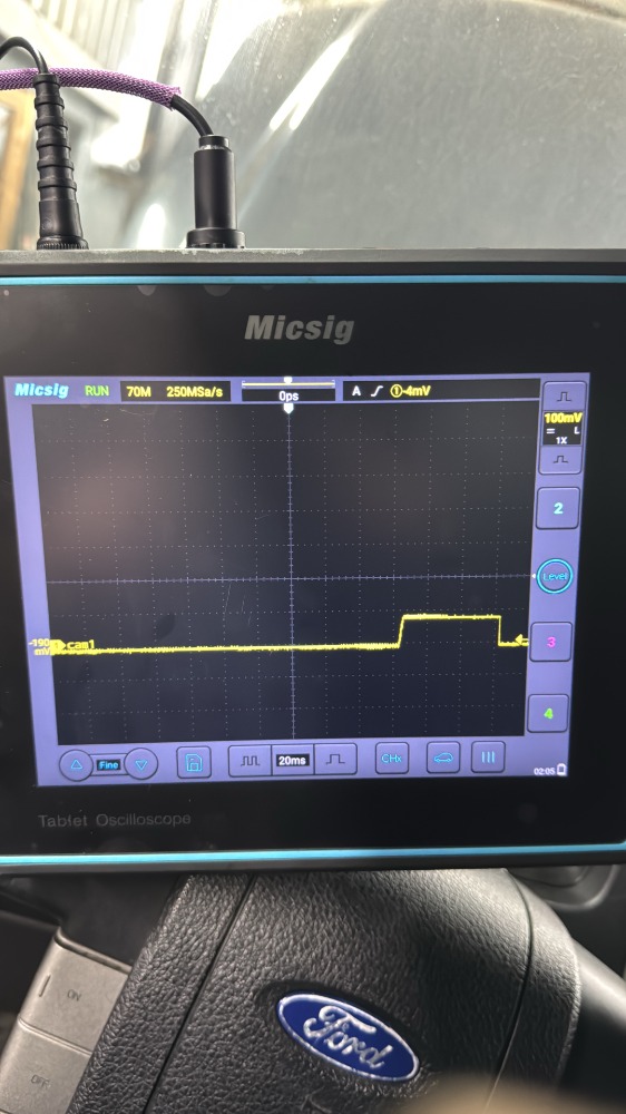

I am now focused on compression testing and trying to figure out why my injector is pulsing like a plateau at 80ms. I am going to really kicking myself if the plugs are fouled, lol. We definitely have spark according to the scope and verified one cylinder externally. It will not run on either or off of a pressurized bottle of clean new fuel.

got down to where you are describing the injector waveform and there is no waveform!!! I need it 😊 please submit
Also, it sounds like it could be flooded? (why it won't start with a fuel source) We need to see one plug.
Does Cranking cadence sound like it has good compression?

After you do that. I need better captures of your injectors.
A sync signal on one injector (voltage waveform) and the amp clamp on a common fuse they all share. Even if the coils are on that same fuse, that's okay. But I need that sync with it!

Paul, the truck started with new plugs, lol. Would you like me to send you any scope data? I can drag it back out tomorrow and get it hooked back up. if you would like.

No, only if it still didn't start. So it was flooded then!
Now to be sure you know why that happened, so it doesn't do it again.

So I believe that the truck was flooded from having multiple no start conditions and continued cranking from us, the owner and the other shop, that and when it was still starting, only running for a minute to be moved in the yard for mowing. I am going to go manipulate the harness for the injectors again to make make sure we didn't misdiagnose it as plugs and it starting due to the movement of the harness when doing the compression test and plugs.

100% then, you'll be fine. Tell them to run it longer!!
