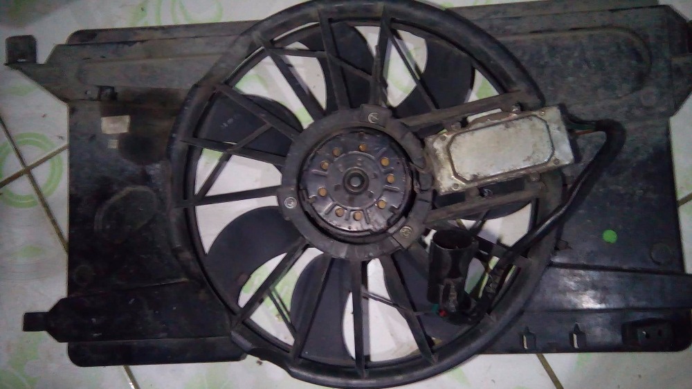

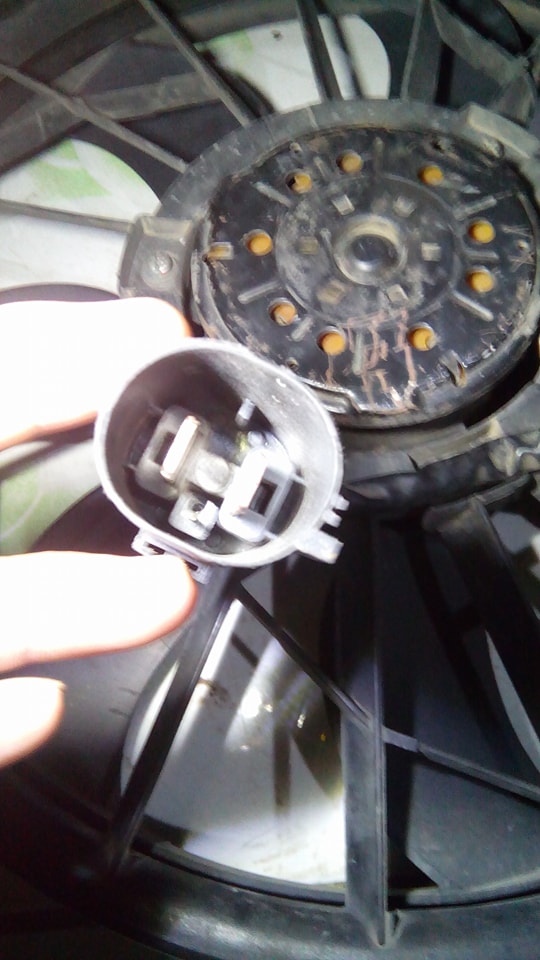

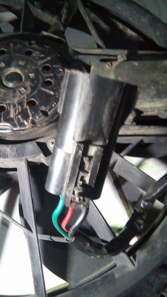

Hello Guys i have ford focus 2009 model (diesel engine) i have problem on my fan here the picture below
anyone know how to test this fan?
thank you guys i wait for your reply THANK YOU
3 wires
More POwer
3 wires
More POwer

Which diesel engine?
The last focus fan control module I did had, power, ground and control from engine ECU
The control is a 12v pull down type circuit.
Scope the control wire and command fan on with scan tool to see if you have control present

PCM controlled fan
Wiring diagram attached - Thanks BBB Ind.
Black Is Ground
Green is Low Power
Red might be High? Colors different from diagram. Check before you let the smoke out.
Easy diag. Check it out & let us know what is missing.
Black Is Ground
Green is Low Power

Red - 12v hot all the time
black - ground
small gauge green wire - control to ecm there 9v on that wire pull down type
black - ground
