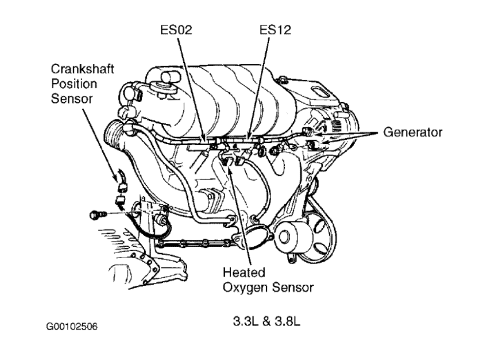

I am looking for the position of the crank shaft sensor in my '96 Dodge cravan. Please help!!!!!

4cyl or 6 cyl?

If it is the 3.3 or 3.8, should be at the transmission end of the engine just above where the differential is housed.

Look at the attachment...
