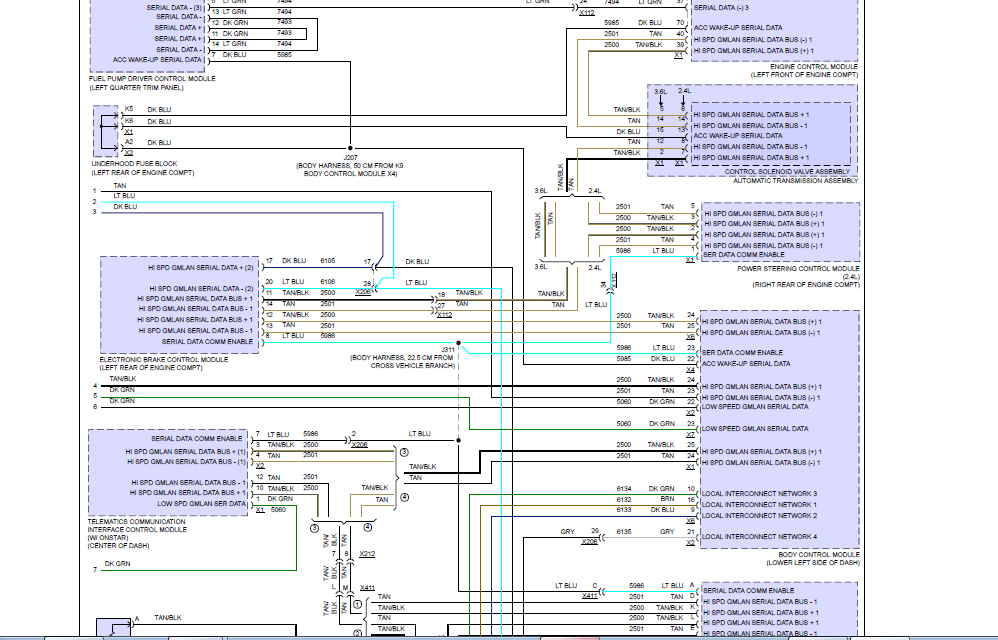

I'm knowledgeable in the CAN field but I certainly could learn more about it. I had a question about your bypass test, I guess to understand it more I would need to look at a wiring diagram for it so I can see just which circuit you applied power to to wake up the other modules. So my question is which circuit did you energize?
Could your post up a picture with the wiring diagram associated with it? I am a visual learner lots of times.

I uploaded a snip of the wiring diagram. The BCM monitored Pin 22 of Connector 4 for the short. The modules I unplugged were on this circuit. The BCM flags a code for a short on this circuit that doesnt exist. Pin 23 of the same connector is the wake up circuit I used a testlight to send voltage down and wake up all the modules.

Hi, very good one! Do you know what voltage is the wake up circuit? Hypothetically speaking you could bypass a wire from the 15 ignition to BCM output (wake up circuit), if the problem of BCM is only this!? Of course there are other things to consider.

I used a test light connected to power on the wake up lan line. I just pulsed it with the test light a few times and it woke up.
8 years 10 months ago #16434 by derekoliveira
The wake up line uses battery voltage and using a test light to wake up the Can Bus it works! It means that need only to see a pulsing signal to do the work, not 12 volts,
judging by the test light voltage drop!?
Thank you.
8 years 9 months ago - 8 years 9 months ago #16483 by castironman
Another way to think about that is that Mr. Trapp used the test light to limit the amperage and avoid a direct short to power (that will give you 12v at 650 mA at the most and if you use a LED test light even much less - I have one that gives 35 mA). The module use that signal as part of either a voltage divider or input to a comparator (a amp-op) to protect its internals.
