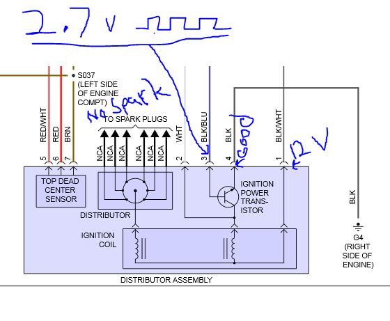

Hi, Guys and Gals.
I have a question about the coil control voltage on this Stratus. It is a no spark, no start. Power is good. Ground is good. I have a control signal, but it is a 0 - 2.7v Square Wave. The 2.7 volts is confusing me. Is this normal, and I have a bad coil/transistor? Or, should I have a 5v or 12v square wave, and 2.7v is not enough? Testlight to battery positive, tapping control for a bypass, toggles 0 - 12v, but still no spark. No current. I believe, I need a new Distributor/Coil, but am not 100%.

I think you're right about needing a distributor, 2.7V definitely seems low. I can think of no reason why an NPN transistor like the one the diagram shows would generate that kind of voltage on the base circuit. Replacing the distributor would be my next move.
My only question would be if the 2.7V is being generated by the PCM or the distributor. KOEO, is the voltage 2.7V on the black/blue wire? Or, is it 0V?

Actually, I take it back! You may just have a bad coil inside the distributor. I got to thinking about this video:
The coil turn on ramps are around 2-3V (tough to see the exact value). It's not the SAME engine, but the distributor design is very similar.
I dunno if the coil is replaceable separate of the distributor? If so, maybe take the cap off and check for coil control? Otherwise, proceed with distributor replacement. :lol:
