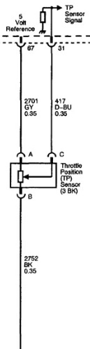

Hello,
Im Cris, i watch lot off videos, throw scannerdanner, they great! i just confused on the this car, i have service codes, p0105,p0107,p123,
map senor problems, and high idle voltage on tps, this could be little long, explaining what ive done so far: saturn wont shift,but in 2nd gear, i have no service codes 4 transmission!! i bought myself a verus, because save money on repairing my own vechicle, it gives great detail whats going on, do test. i went to the transmission section, went throw the test turn in on all the seleniod, comferm they were working,transmission reads the tps information some how?
the saturn has high idle, turn it on it runs up to 3000, then goes down idles at 1900, so i bought a new tps, thinking it was bad! i check it had 5 volt supple, i used a light tester, to verify good ground be puting one end on positive, & toughing the ground on plug end 4 tps, it light up, i used the volt meter to test the signal wire, unplugged test if there was voltage on signal wire unplugged, there wasn't. so i mounted tps on throttle body, plugged it in, back probed the plug in, conform it had 5 volts.i back probed the signal wire with key on, the voltage in closed throttle is 4.3 volts???????
i replaced the map sensor 7 months ago, i found that the iac controls the idle, so i put a new one in, didn't change, ive sprayed the intake with carb cleaner to see if it leaking, didn't change idle, so not leaking, i sanded 3 ground point, grounds, one under intake, one connecting block to head, one one fender back by firewall, thinking computer messing up because bad ground?? nothing ive done so far changes idle, to normal,still idle really high!! i looked at wire diagram back tracked the signal wire , ground 4 tsp to computer think it good??? the scanner says idles at 99%, 4.3 volts closed throttle on tsp, shows no readings for sht,or long term trim , im trying to show u the scanner readings off data,
Computer problem????? im not master mechanic, i just learn as i go, try figure out how to fix vehicles!! forgot to mention i have a code 4 ac relay?? too, dont know if that would affect the voltage off tps, closed trottle,or idle problems?
cant load pics??
so write data
RPM 3301/////// TPS V 4.35
TPS% 99/////// Coolant 185
intake air (F) 71////// HO2B1 S1 mv 977
HO2S B1 mi 846 ///// INJ1 CMD 4.26
INJ 2 CMI ms 4.27 /////// INJ 3 CMD 4.26
INJ 4 CMI mvs 4.27////// Lean Rich Trans 0
LN Rich AVG 0 ////// AF ration 12.9.1
OPEN Loop///// ST Trim % 0
LT TRIM% 0 ////// FT Cell 22
MAp IN hg 9.1 ///// Map (V) 1.08
BARO inhg 22.4 ///// Airflow GM/sec 20.32
IAC postion 121 ///// Desired idle 763
Id appreciate all insight ,suggestions , thanks 4 looking !!!
update computer didnt fix it 60.00 wasted!!!
codes 105 map or baro pressure circuit problem
code p0300 engine misfire, it cylinder 3
po530 AC Refrigerant pressure sensor circuit
i may fail at fixing!! but dont give up!!!! more research.lol

Whoa, that TPS is WAY too high for idle. :silly:
You're certain that the TPS signal wire showed zero on the scanner with the TPS unplugged? If so, then I think my first suggestion would be to leave it unplugged and see if the idle gets any better. With any luck, the PCM will go to a backup strategy and rely on the MAP signal instead.
These sensors are pretty simple, so I doubt it's an installation issue. :unsure: Can you do some more voltage measurements for me? KOEO, with the TPS plugged in, backprobe all three wires and tell me the voltages.

This what I know, voltage with tps unplugged is 5 volts, believe ground is good, the signal wire shows no voltage, new tps, but when I plug it in yes get 5 volts,ground, but signal wire says around 4.3 volts??? Closed throttle???
Vehicle running plug & unplug tps doesn't affect idle, no difference in idle?? Plugged in or not????
Last edit: 8 years 10 months ago by CCordell.
8 years 10 months ago #16013 by Andy.MacFadyen
Replied by Andy.MacFadyen on topic 2003 Saturn l200 high ideal
What is the voltage on the signal wire at full throttle ? --- thinking wiring reversed
8 years 10 months ago #16037 by Tyler
Replied by Tyler on topic 2003 Saturn l200 high ideal
Kinda what I was thinking, Andy. :cheer:
Thanks for getting back to me on that one. Kinda like what Andy was saying, if you sweep the throttle, how does the signal voltage respond?

The TPS is working backwards. :blink: It should be closer to .5-1.0V at idle, not WOT.
Do you recall the wire colors, and their voltage readings? 'Cause either the TPS itself was manufactured incorrectly, or the sensor is wired wrong. This is the OE wiring diagram for the TPS:
What is the MAP reading at idle? I'd be tempted to ignore the MAP code for now - it's possible that code is setting because the PCM is using rationality logic by comparing the MAP to the TPS. Right now, your TPS is showing wide open, while the MAP is probably showing closer to idle, and the PCM doesn't know who to believe. :silly:

I put 3 different tsp in know, all had same readings 4.3 v closed throttle, they gray wire, has 5 volts unplugged, red wire signal wire, black 4 ground.
8 years 10 months ago #16049 by Tyler
Yeah, that A/C pressure sensor is way high, too. :blink: I just checked the diagram, and they don't share any wiring outside of the PCM.
The ground has 4.00V on it? If that's true, then you're looking at the issue.

I cut red signal wire,on the tps, to see what it says before going to computer, it said .4.3 volts
I thought that 3 sensors run off one 5 volt ref from computer? Map senior has separate 5volt ref from computer, guess checked for good ground, don't believe there was voltage on ground wire??? Dont remember?
If short,they should read voltage leaking on ground wire??? Im not master learning as I good!! Lol
8 years 10 months ago #16052 by Tyler
Would you mind doing a recheck of the the three TPS wires, KOEO, when you can? Because that 4.0V on the black wire is a big red flag if it's true. The fact that two of the 5V ref sensors are showing similar voltages would point towards a PCM ground problem, or possible harness damage.
You're correct, they do. But earlier, you posted some readings that showed the MAP at just over 1V, so I don't believe the 5V reference is shorted anywhere. Because the signal voltages are high on the TPS and A/C pressure sensor, the grounds are more suspect.

Thanks 4 everyone's help!! It running & shifting know happy!!! Its my fault!! I checked the plug ends on the tsp & ac pressure sensor, they have same plug end!!!
I bought car had whole in block, replaced engine painted it, I put the ac sensor wire on the tsp, looked at them, switched them & it works fine!!! Live & learn!!!
It drove around 4 yr like that!! Switched plugs wires,ends thanks 4 everbodies help, appreciate all!!

:lol: Well done, sir! :cheer: I suspect that the 5V and signal wire pins are reversed on the TPS and A/C pressure sensor, so that's why they generated inverted signals. Seriously, great job catching that. ;-)
Honestly, something you said earlier caught my eye...
I wondered why you said the signal wire was red, 'cause the diagram says it should be dark blue. :huh: But I let it go, figuring someone had installed a replacement pigtail at some point. Shoulda caught that earlier. :blush: It didn't help that the A/C pressure sensor was on a separate wiring diagram.
