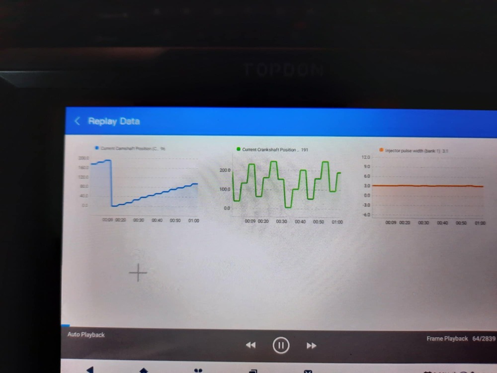

1 year 10 months ago - 1 year 10 months ago #74135 by Jerry McGillis
Waveform was created by Jerry McGillis
[img][attachment=undefined]98641060-3023-4fd0-99b2-965e5eae11a9.jpg[/attachment][/img] [attachment=undefined]98641060-3023-4fd0-99b2-965e5eae11a9.jpg[/attachment] Hi all, just wondering if anyone can help read the waveform I got on my 2003 jeep Wrangler TJ 4.0
Having problem loading the image
Last edit: 1 year 10 months ago by Jerry McGillis.
1 year 10 months ago #74167 by ferris48
Replied by ferris48 on topic Waveform
I'm just speculating here but i think it's because the camshaft turns 2x slower in relation to crankshaft and when the counter reaches a limit (200 or 255 not sure), it restarts at zero. The current camshaft position probably looks smoother because it turns the slowest, while the current crankshaft position "waveform" looks jagged because the computer couldn't spit out enough points to to make the graph look smooth as your scanner connected the dots to make that graph. Perhaps if you graphed the current crankshaft position pid solely the picture would improve.
