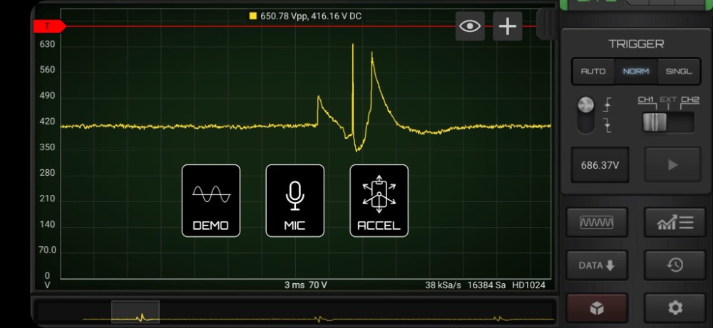

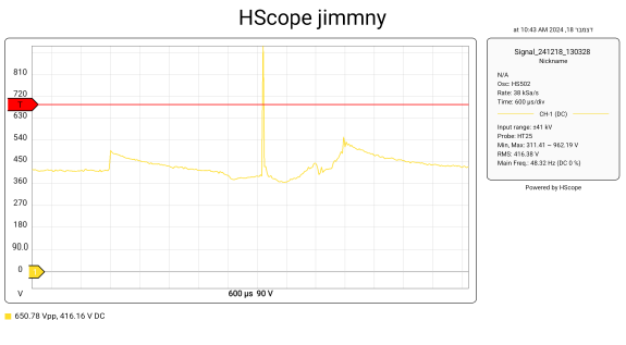

hi all
someone known with this secondary ignition waveform ? its a 2022 suzuki jimnny C.O.P , measured with H502 (Hscope) using hantek AT25 probe.
my voltage config is wrong , should divided by 20 , sprak line is around 48kv , all cylinders shows the same waveform
i wonder if it can be diagnose , burn time dewll time etc

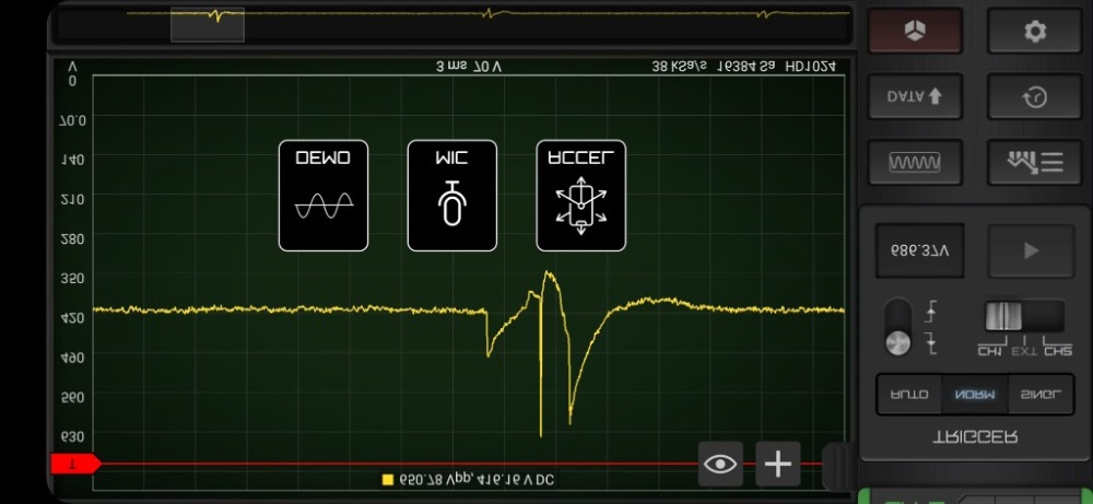

How and where are you capturing the waveform? Judging from the dwell section, your waveforms are upside-down. Does your scope have an invert function?
If we invert it,....
it still looks terrible but, now, it looks like, possibly, a shorted secondary with, absolutely, no gap to jump. Is this a 2-wire coil? Can you capture a primary voltage waveform? Do you have an amp clamp to capture a current ramp of the coil?
