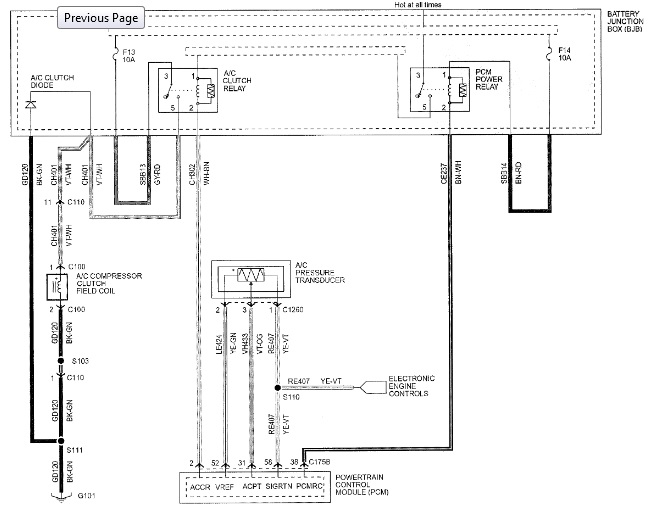

Hello guys, Can you give me wiring diagram for Ford Focus?. Because , my car compressor did not engage.

Merry Christmas! :cheer: I won't be able to provide you with a true diagram for your Focus, as they don't offer a diesel Focus in the US market. :-( This is the diagram I have for the 2.0L gas engine:
File Attachment:
File Name: focus.pdf
File Size:194 KB

Yes Thank you a lot hehe, this is very helpful to me for diagnosis
