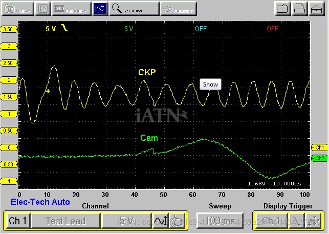

For reference, I grabbed a known good cranking CKP waveform from iATN:

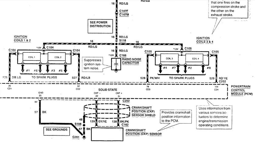

I know that Exranger06 knows which pins to test at the PCM, but here's a circuit diagram for anyone else following along:
If you haven't seen it already, this ScannerDanner video demonstrates what we're looking for perfectly. Different engine, but the design of the sensor is identical.
Not sure if you have a scope available. If not, not a problem, your DVOM will work just fine. Connect your test leads across both backprobes and switch the DVOM to AC voltage. Crank the engine and look for a reading. How much voltage you'll see will depend on cranking speed, but I'd *guess* you're looking for around 500mV. Obviously, 0V would represent a problem.
The design of this sensor circuit is somewhat unique (read: weird), so please don't hesitate to ask questions about doing this test!
