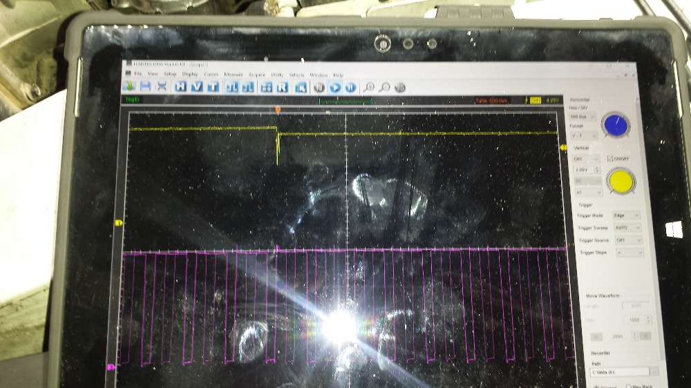

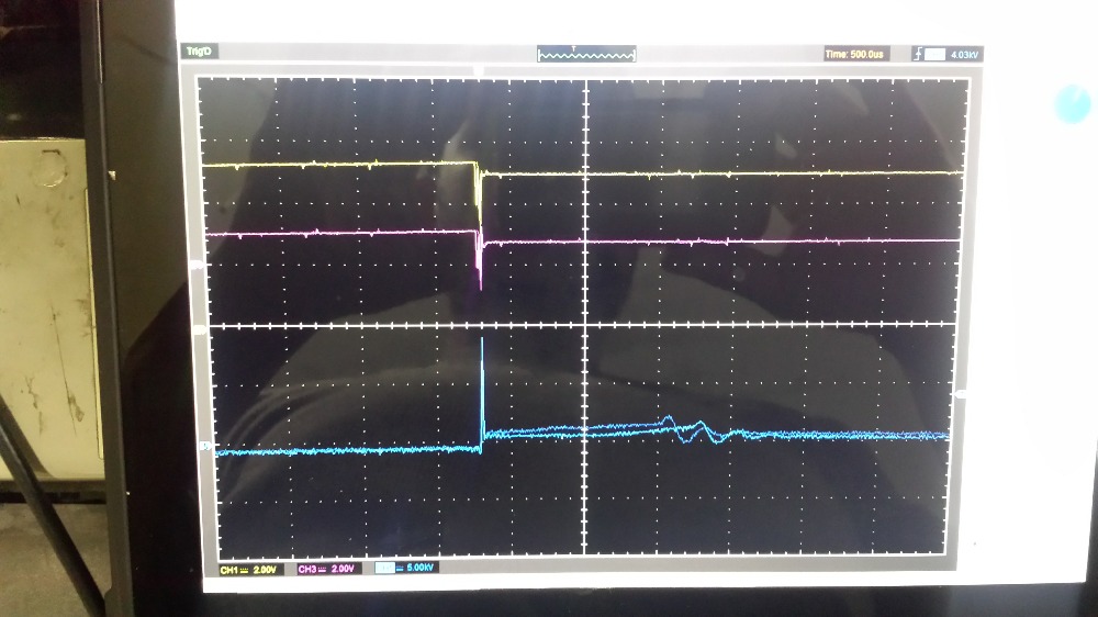

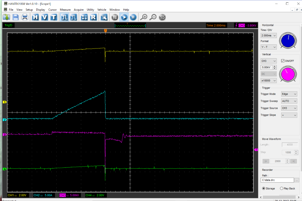

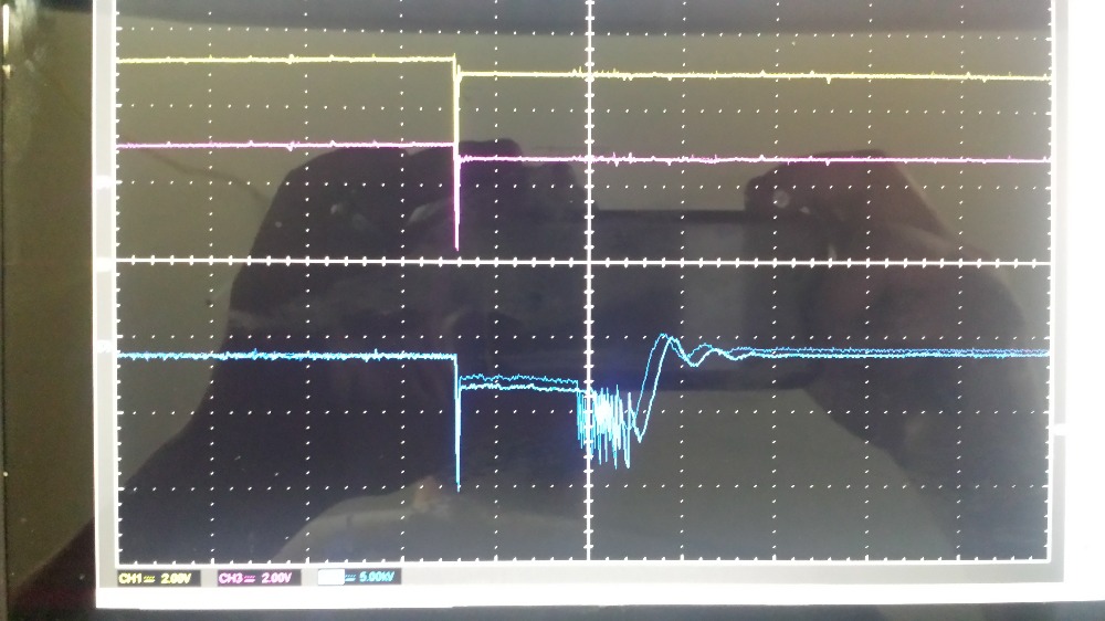

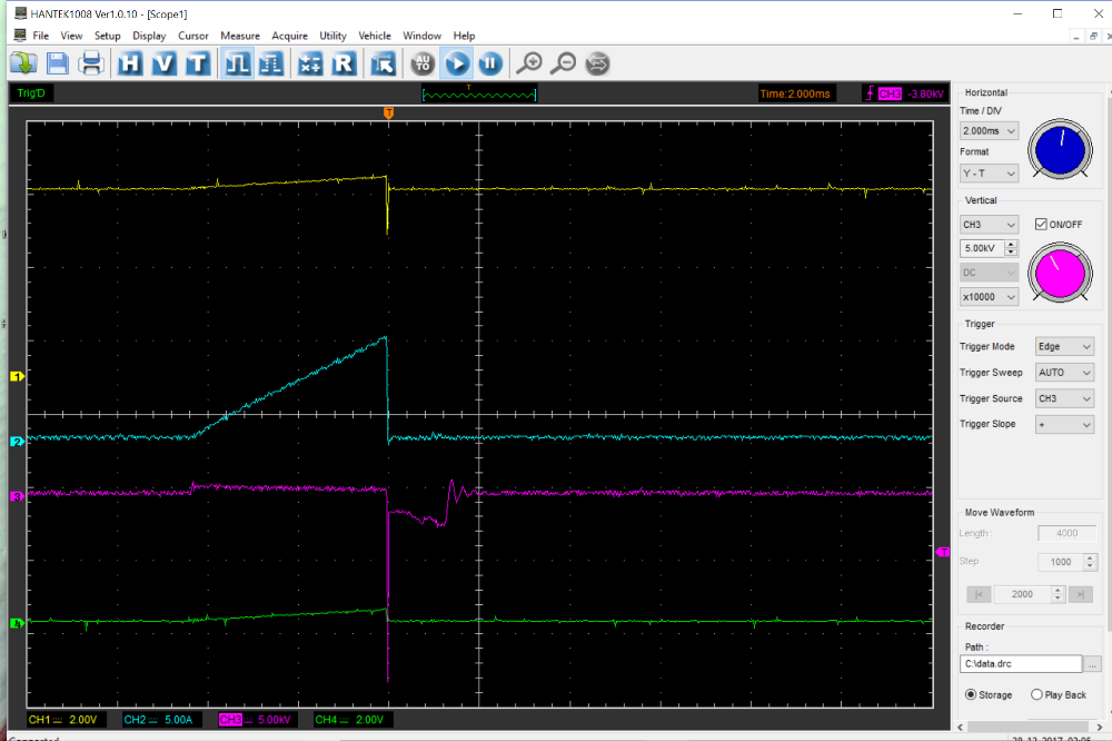

I posted earlier about a high idle lean condition on this truck, after repairing a few vacuum leaks and resetting the minimum idle I got the truck idling normal until I snap throttle. After the throttle is snapped it seems like the truck loses control of the iac for a few minutes. After some scope work because i didn't trust all of the scan data values this what I found. yellow is 5vref at pcm harness, blue is my primary current ramp, purple is cylinder 4 secondary, and green is my maf ground. So internally damaged pcm, possible shorted injector, maybe shorted ignition control, bad ground. still trying to find the answer. Fuel trims are still a lil lean. Any thoughts on how all those ignition patterns are showing up everywhere else. The truck seems to run fine until throttle is snapped and everything gets pulled further to ground.

I think you are perhaps seeing a scope artifact --- you are picking up ignition interference in the leads. Try rerouting your scope leads

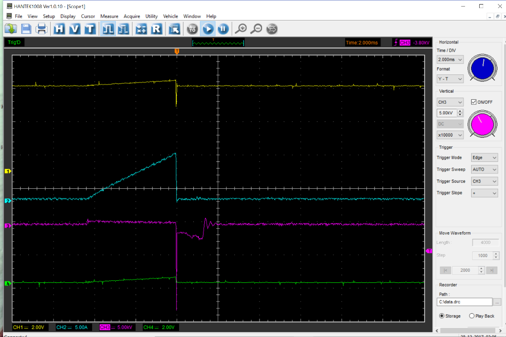

I believed that initially, but the jumps in the scan data, the loss of the control of certain circuits. That's the also the latest version of shots I've taken. You can see that pattern everywhere, it's the only reason I can find that is causing loss of control. I've routed the leads in all sorts of different ways. I will post all of the shots I have. I have no explanation other than that interference to cause problems in other circuits. It's like all the critical sensors are reset when I snap the throttle.

These are the only ones on my phone
