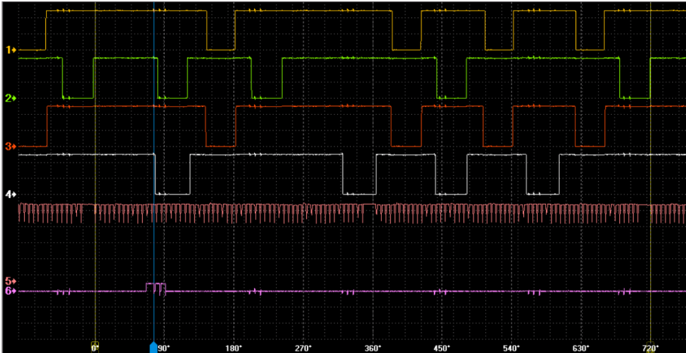

I got a known good cam/crank waveform from Rotkee. It appears that the CMP signals spend most of their time at 5.0V, so I'd tend to think they are pull down:
So I disconnected all 4 cam sensors and cranked and it did not read 'sync.'
Interesting. It's a pretty rough test, but that tends to make me think that this is not a timing or CMP/CKP input problem.

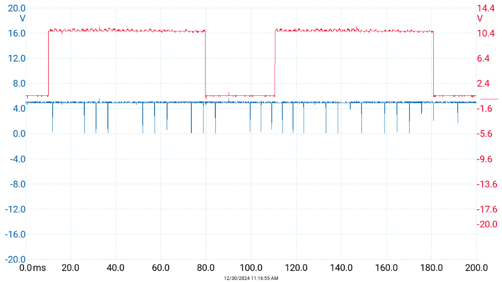

Yes, it has been a learning experience...but fairly smooth sailing. I connected everything up this AM...and gave it a crank.
Channel A (Blue) set to the Bank 1 Exhaust Cam, Channel B (Red) set to the Crank. I cannot speak to proper cam/crank correlation, but the signal looks appropriate. Buffered VREF (11.5v) and the sensors get pulled down for a moment to zero. I suppose I could test the three other cam sensors but perhaps it is not necessary.
Also, during cranking I noticed that the 'DeChoke' PID moves back and forth between Yes and No. Also, rail pressure from the high pressure pump sits slightly above desired while cranking.
I've attached the Pico file here.

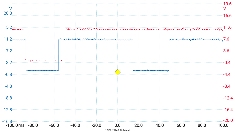

1 year 10 months ago #76008 by Tyler
Replied by Tyler on topic 3.5 Ecoboost swap project trouble
Unfortunately, I don't think that the forums will accept raw Pico files for upload. I'd recommend zipping them, or use whichever file share service you like.
From your capture, I'm not sure that you're actually probed into the CKP circuit? There's not nearly enough frequency in the signal to match the known good I posted earlier, or any other known good I can find. The CKP should be transitioning several times within the blue CMP pulse.
Either that, or something is really wrong with the CKP signal.
  • matt.nelson
  • matt.nelson's Avatar Topic Author
1 year 10 months ago #76011 by matt.nelson
Replied by matt.nelson on topic 3.5 Ecoboost swap project trouble
  Yes - my mistake. I ended up making an error in the backprobe. Attached is the proper image. The crank signal looks odd but I think it is because of the resolution of the device.
I ended up calling a company who is into engine swaps and wiring and he seemed to think it was likely related to the PCM. I ended up sending him all (3!) of mine and he will look into them and sort things out. Apparently he has the means of bench testing them. I will update as things progress.

I wanted to chime back in here to update anyone who reads this someday.
Turns out that there was one bent tooth on the timing wheel. I have no idea how it happened, since the transmission has never been removed from the engine since it left the factory. The CKP must have just got tired of it and gave up. I pulled the trans, pulled the flex plate and bent the tooth back into place and replaced everything and the truck works beautifully now.
Shame on me...I should have worked to learn how to make the CKP signal clearer in the scope reading on the computer. I read so many times that if you see an RPM signal the CKP is good and I thought that the problem would lie elsewhere. Should have looked much more carefully at that CKP signal! It does seem a little odd to me that the PCM would not produce a code for seeing two TDC's per revolution. Something like CKP signal implausible. Ford, if you're reading this consider this programming change or even better make sure if you have a factory worker that drops a timing reluctor wheel on the floor make them get a new one instead of assembling an engine with a damaged one.
