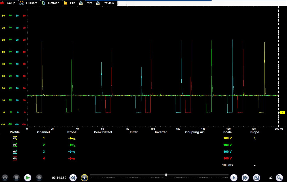

This Wave is of Bank 1 Injector voltage, before things go crazy.
Yellow is injector 1, then big a gap where injectors 8 and 4 fire on bank 2, then GREEN is injector 3, then a small gap where injector 6 fires on bank 2, then Blue is injector 5, and Red is injector 7. This is what I expect to see.

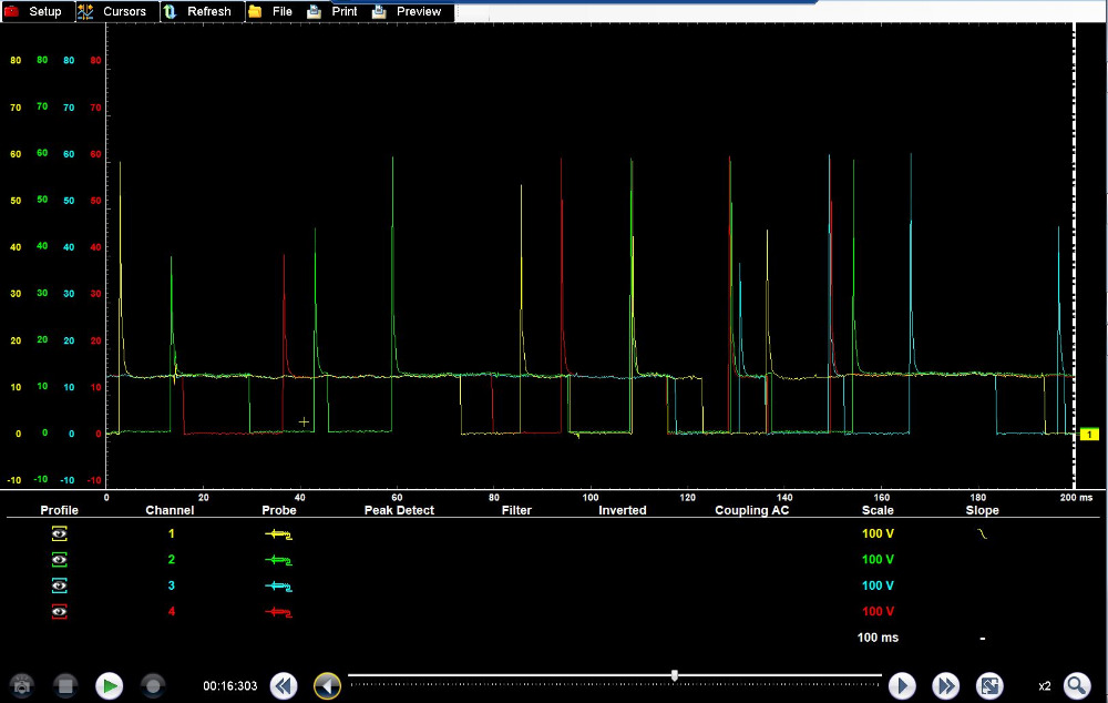

Then, after reviewing the .vsm, I noticed this, brief anomaly while the engine was running.
Notice the three consecutive blue and red events. They passed by, UN-noticed, as the pattern returned to normal..............Until.....POW! Die.

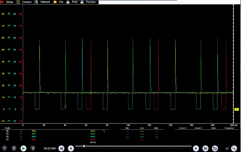

This is what it looks like when the injectors are going crazy..

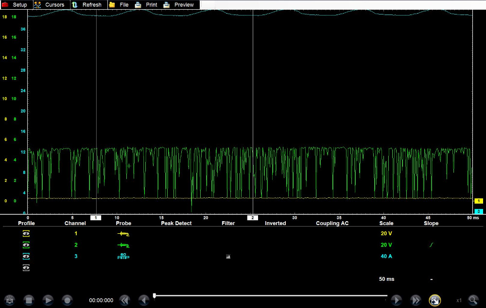

I have been all over powers and Grounds. Why/How are the injectors and coils being energized? :blink:

This is the CMP signal after the engine dies and injectors are going crazy.
