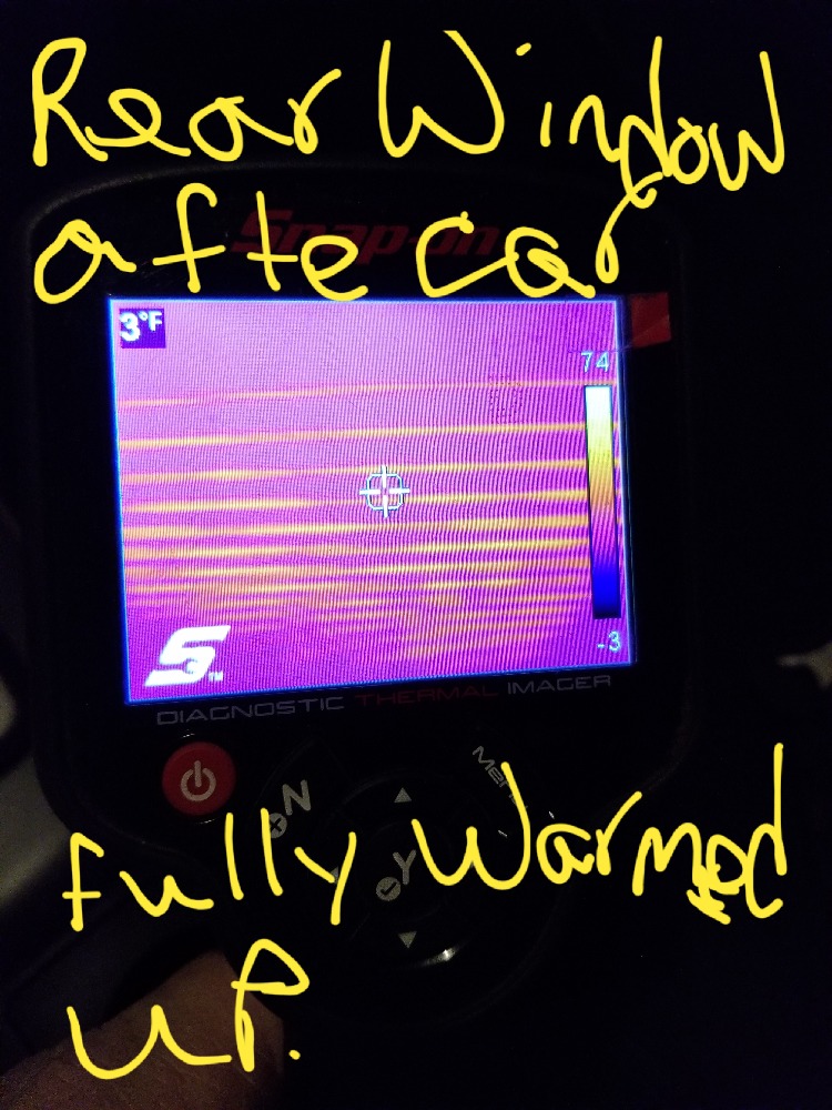

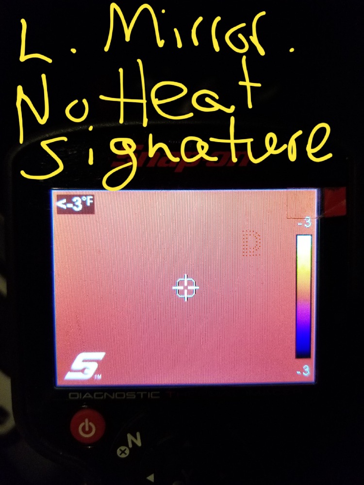

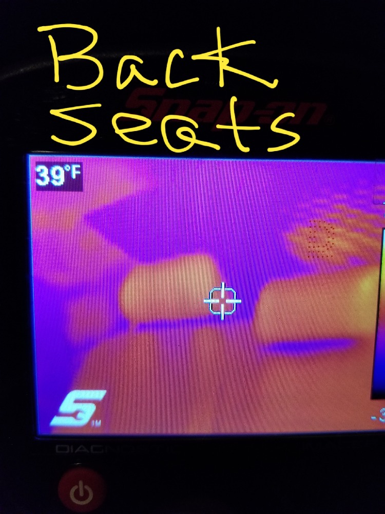

Ok tried a Photo with a Flash and it doesn't show on the mirror so I turned the flash off and luckily it's white enough out that you can see it in the mirror I also put a yellow square around it just to enhance the picture a little bit. Hope that helps or I'm going to get schooled on a symbol.
The rear window defrost works or at least my son says it does. I don't think it does as I think the heat from the vehicle is hitting the back window and causing the elements to heat some as it's a very slow melt where the lines are.
The reason I say this is I used my thermal Imager and I can see heat coming out the vents clear is a day in the vehicle but nothing on the back window and even the seats are warm and they're not even heated seats it's just the heat hitting them causing them to warm up creating a heat signature. The defrost light is on it puts a little bit of a draw when you kick it in as they do in most vehicles but I'm not getting any heat signature off of the mirrors either.
It's a little too cold for me tonight -8 or below with 25 below wind chill so I'm going to head inside and rethink a different approach tomorrow which will probably be hitting the fuse box first as I have to sit down and look at your supply diagrams which I thank you for and you're still the man!!!
I knew that thermal imaging device but come in handy more than just a few times. It was a demo so I saved a little bit of money compared to retail I don't know if that was good or bad but it's definitely proving to be a good tool as my Nepali neighbor had me over tonight checking his heater vents because they think it's too cold in their house.
I showed him everything was working fine and rest assured him that it was and he was okay with that. They're fairly new to the US within a couple years so whenever they have troubles or whatever they call me as I know quite a bit about a lot or try at least. There's always Google when all else fails as I tell my kids and you just have to decipher the information from there.
Thanks for finding those diagrams for me! I am amazed at times how you guys come up with that stuff. Some of you guys must have hidden cubby holes you keep that stuff stored in and just poof upload it and there it is for us. Ha Ha... Lol....
Heat signature pics from car. Marked with yellow wording.
No Heat Signature from the mirror,
8 years 10 months ago #16327
Replied by Tyler on topic Toyota Corolla S heated mirrors question
Ah yeah, that mirror isn't heating at all, is it? :lol: In that case, I suspect you're gonna find a popped fuse. That MIR HTR fuse doesn't feed anything else, so your list of suspects is pretty short.
